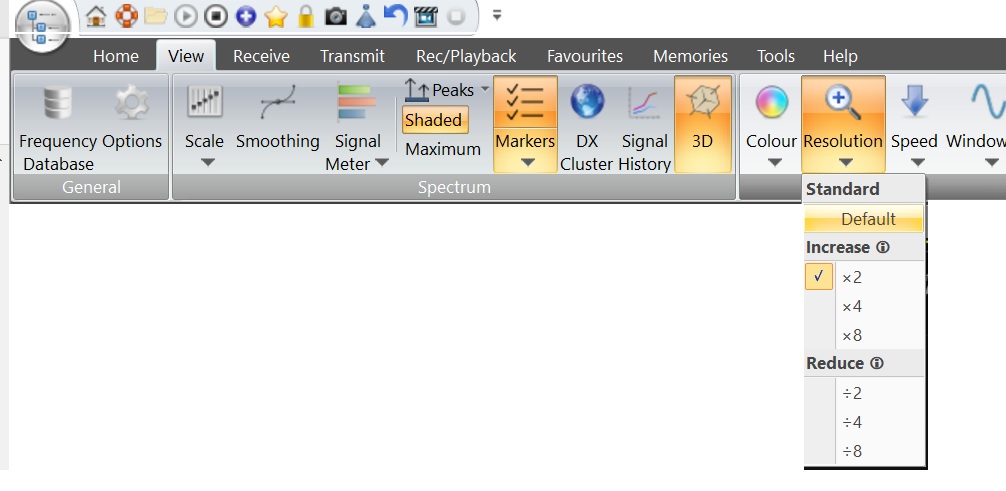

Try a lower Waterfall resolution, I suggest Default - I think we're overloading the card.

OK will try -2 as it was already 'default'. I'm using a GTX 1060, Thanks Simon.

MikeF wrote: Sun May 16, 2021 7:17 pm OK will try -2 as it was already 'default'. I'm using a GTX 1060, Thanks Simon.
I don't think a 1060 is enough for this bandwidth. And I really must see a screenshot while the software is running, not when it's stopped.
