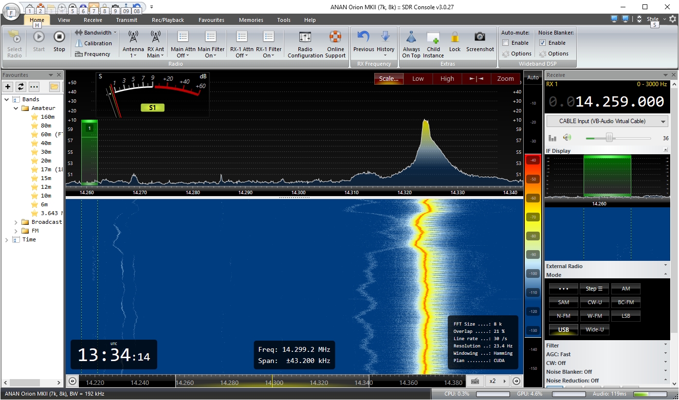

just wanted to give SDRConsole with my Anan 7000 a try... but does'nt work (RX) ... see Screenshot (should receive "normal" SSB sigs on 20m)
Any ideas?

Looks like you have the 6m pre-amp on. (under Radio Config button)

Many thanks, Leon. You solved a problem for me, too.

Leon, thanks!
The default-settings are really strange

I'll make a request to change the default setting. 73, Leon
