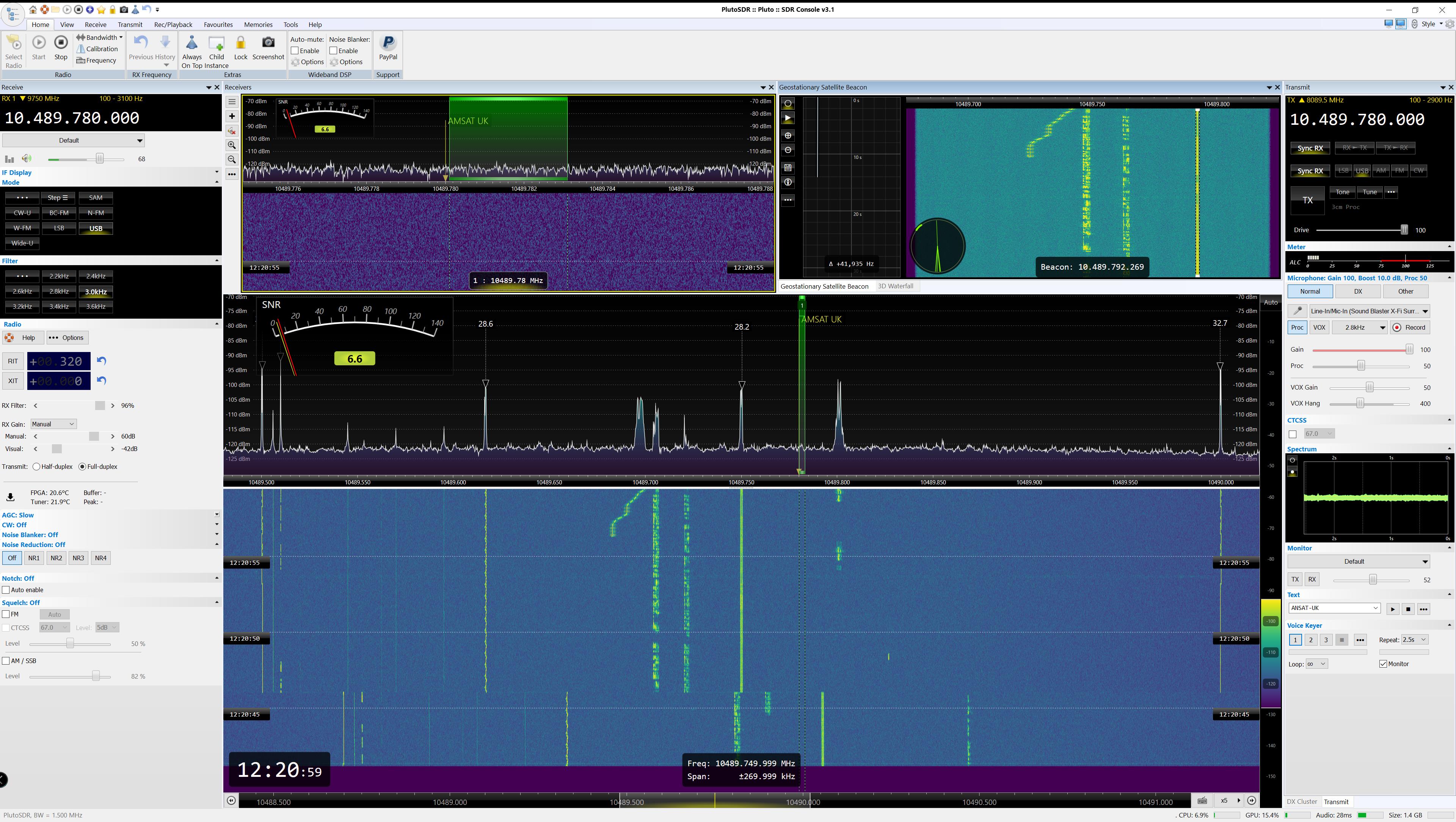

Screenshot please and show the Radio pane in the receive DSP - this way I can see the gains. The spur and mirror is due to IQ and can usually be corrected.
I've attached a screenshot for QO-100 where Pluto is actually receiving at the LNB frequency - note the gain settings.
At 144MHz Pluto is working outside the spec. I have no spur when receiving on 144MHz.
