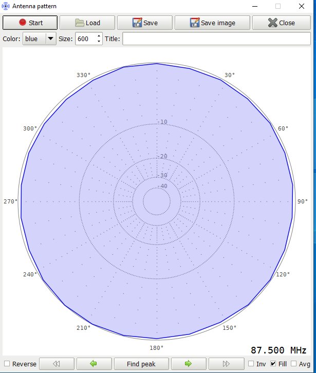

The software controlling my Sony tuner has this feature, it's simply plots relative signal strength on a chart. You just hit the start button and again to stop it along with controlling the rotator and the software assumes it's done 360°
I've found it useful to compare performance when I've changed Yagis.
I'd give a working example but no mast or antennas at the moment so here' s a grab of what it looks like.
