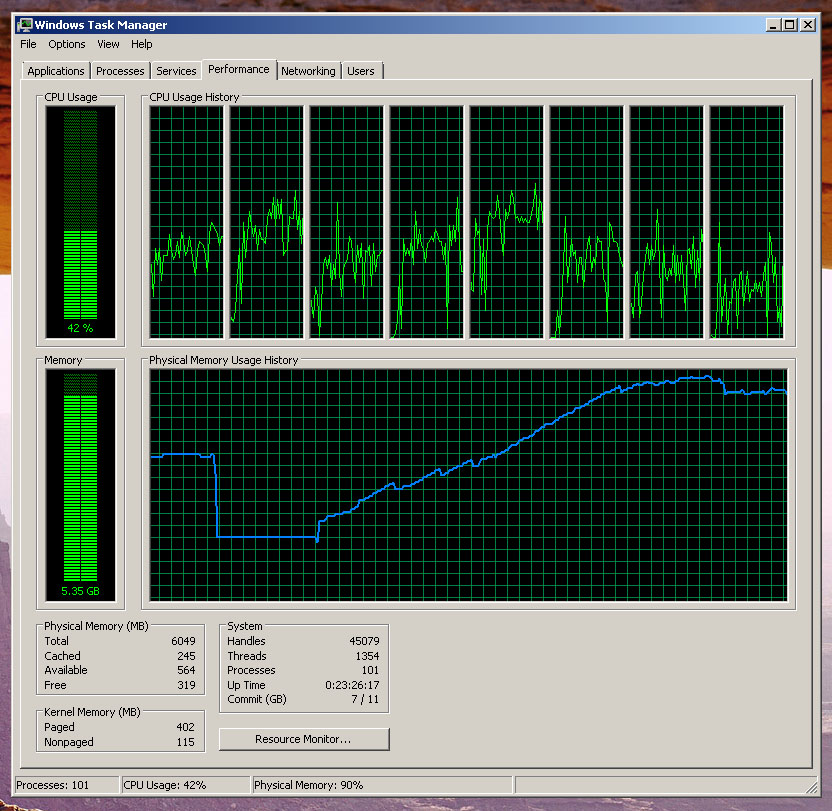

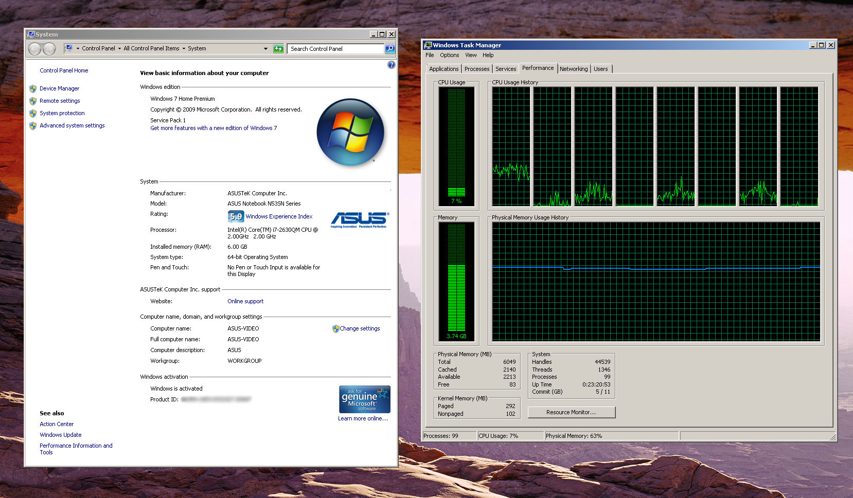

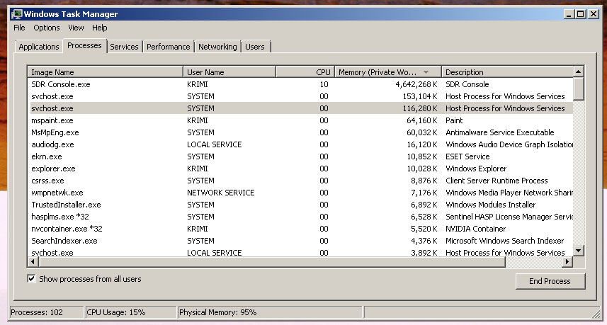

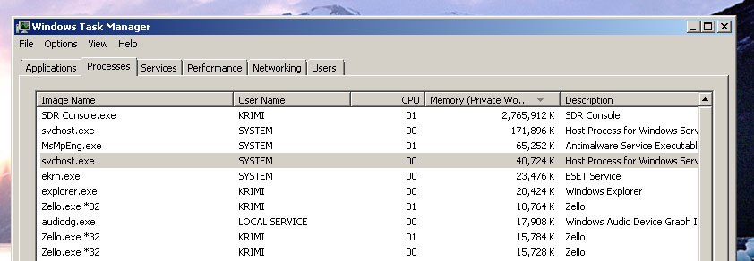

Well,
I will need a new computer for sure, this one is a spare notebook sitting on a shelf, so I thought I might get it to do something useful. I'll post some screenshots on how the memory gets too high when I uplug RTL-SDR and plug RSP1A. You can see it in the graph too. You can see the computer specs next to task manager screenshot /rtl-sdr plugged in/. The sdr console is minimised.. I am not sure if the possibility of turning the display off would help anything, I was just thinking and wondering if it might do any help.. Or maybe other settings will help too.
Thank you for your time
p3t3

rtl-sdr plugged in
rtl-sdr plugged in
RSP1A plugged in
RSP1A plugged in
rtl-sdr unpluuged and RSP1A plugged in
rtl-sdr plugged in
rtl-sdr plugged in
