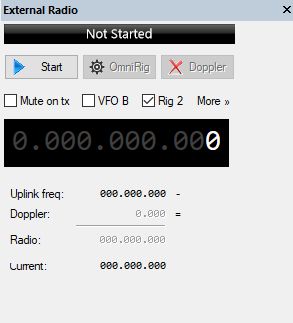

in the Satellite External Radio window, it is possible to change frequency of the connected external radio with mouse click or mousewheel over the displayed frequency.
Question: is it possible to control frequency change with keys / shortcut keys?

I see nobody responded. I'm not an expert on the Sat functions, but can you show a screenshot of which window you mean?

Hi, see attached image.
- extradio.jpg (13.44 KiB) Viewed 6451 times

Lars, please give some more info, do you want to change the uplink or downlink frequency?
I don't have a external TX but playing with my R75 (rx) i come to the following conclusions:
On your picture the Ext. Radio is OFF but when it is ON than you can change the DL frequency with the mouse wheel, like in Console.
In that case the External Radio (RX and TX +/- doppler) follows only when DOPPLER is activated.
Set Doppler to Off if you only want to change the UL freq. Changing the UL freq (tx) has to be done with the RIG's VFO knob.
