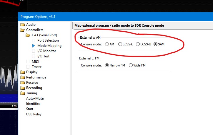

When you say "go to another frequency", how are you getting there? If it's via a stored memory or Favourite don't forget the mode is stored along with the frequency. I personally don't see the behaviour you are describing if I simply enter a new station frequency manually or drag/move the tuning cursor within SDRC.
HOWEVER I know that you use CSV Userlist Browser (CSVUB........ you introduced me to it and very pleased that you did!). So my guess is that you are tuning the next station by double clicking in the list of stations inside CSVUB to tune SDRC "remotely", in which case there is a slightly odd interaction between External Radio Mode Mapping and the serial ports that I discovered when trying to emulate your issue. If you have Mode Mapping set to SAM, then even when not using an External Radio I do see the behaviour that you are seeing.
I don't think this is supposed to happen, but it can be solved by going into Options and set Mode Mapping for AM to AM instead of the default setting of SAM:
Simon, if you are reading this, I don't think this is an intended function of the mode mapping is it?

With the benefit of a night's sleep, if I had looked at my own screenshot properly I should have seen that the title bar in the settings option does indeed say: "Map external program/radio mode to SDR Console mode".
I really must learn to look at what I am doing! So this answers the question I posed to Simon (and also for your information Bob) namely, yes, this is fully expected behaviour when tuning via the list in CSVUB. So if mode is set to select AM as the mode in the external program (in this case CSVUB) then you can choose here whether it then selects AM or SAM as the default mode for AM signals in SDRC.

Yes, your suggestion of changing the "mode mapping" setting works.
Thanks; I never would have thought, or known about, that setting.
