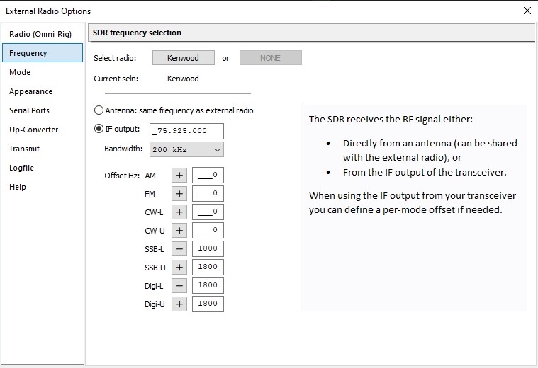

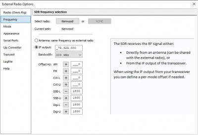

But, as I use a panadapter to get the RX from 1st IF signal on my TS-2000 and TS-2000 have two different IF frequencies on HF by design, depending on the HF band I'm in. I have to choose IF output on External Radio 75.925MHz for 160m/80m/40m/17m/15m/10m band or IF output on External Radio 69.085MHz for 20m/12m/6m.
Check picture 1 IF output.
It would be perfect that I could preset the 2 IFs output and use the appropriate one according to the frequency the external radio is in.
For example, between 1.8MHz and 7.3MHz, SDR Console would select as IF output 75.925MHz. And from 14MHz to 14.4MHz it would select IF output 65.085MHz. So that when I click in a cluster spot on 80m, SDR Console knows that to show me the right waterfall has to be on IF output 75.925MHz. And a few moments after, if I click on a 20m cluster spot, SDR Console, automatically swaps the IF output to 65.085MHz and I have the right waterfall and reception.

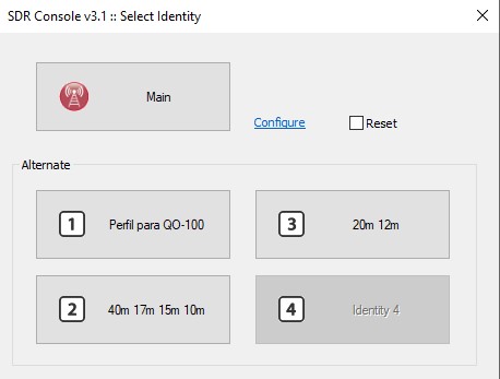

I also tried to have different Identities, but it didn't worked out because the IF output selection is part of the External Radio menu and not on the SDR receiver section. This is a second option as it is not practical changing Identities evey time we change band. It makes sense when changing SDR receivers.
It's just a last resort option:
Identities are fine for me to have different settings to operate QO-100 and HF.
Although every time I change from HF to QO-100 I have to change several settings on External Radio Options, for example on Frequency from IF output to Antenna (as it gets the RX directly from the LNB) and on Up-Converter tick on Up-converter offset. And when I change from QO-100 to HF, do the opposite It would be nice that the Identities also stores the External Radio settings.
