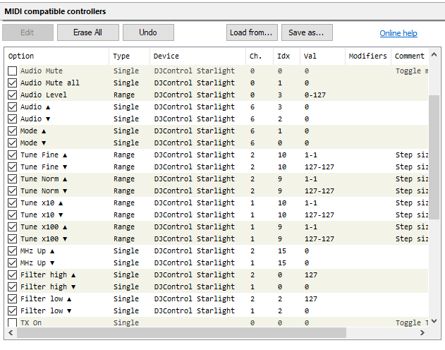

Hi, this is my configuration of MIDI: Hercules DJControl STARLITE, after some adjustments here is the setup that I am currently using, installed for a week so far it had no problems :roll:
Both the VFO and the x10 and x100 tuning are configured to change mode by touch, a function present in the STARLITE.
73 IU4FIR
