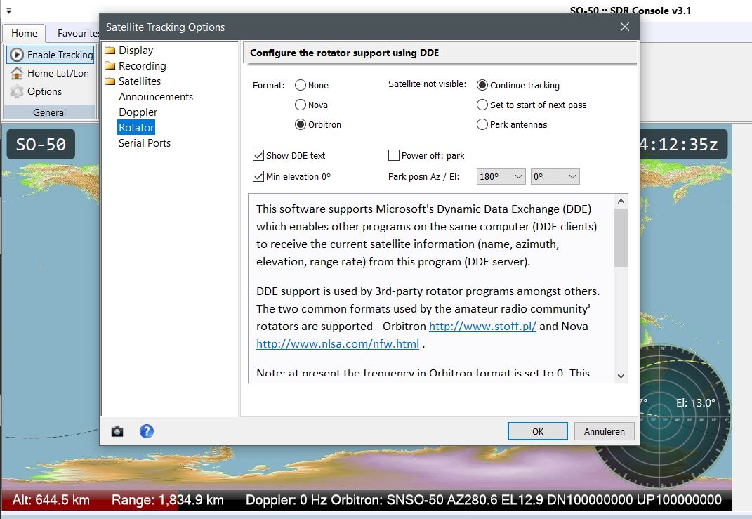

Have you enabled DDE in the satellite options? It's been a long time since I used it.

Yes, it's enabled en sending a string. If I start the "DDEOrbitronToSerial" program, that one is getting the string from SDR Console, only the SPID software isn't getting anny of that data.
I'm not sure if its possible to make changes in the MyDDE files, or that I have to compile those changes. I'm not a software guy but keen on learning.
At this moment I'm trying to figure out how MyDDE is working, It's runned by orbitron, if it can be used as an "always on" program it would work I guess.

OK - my side is good so check the serial cabling?
