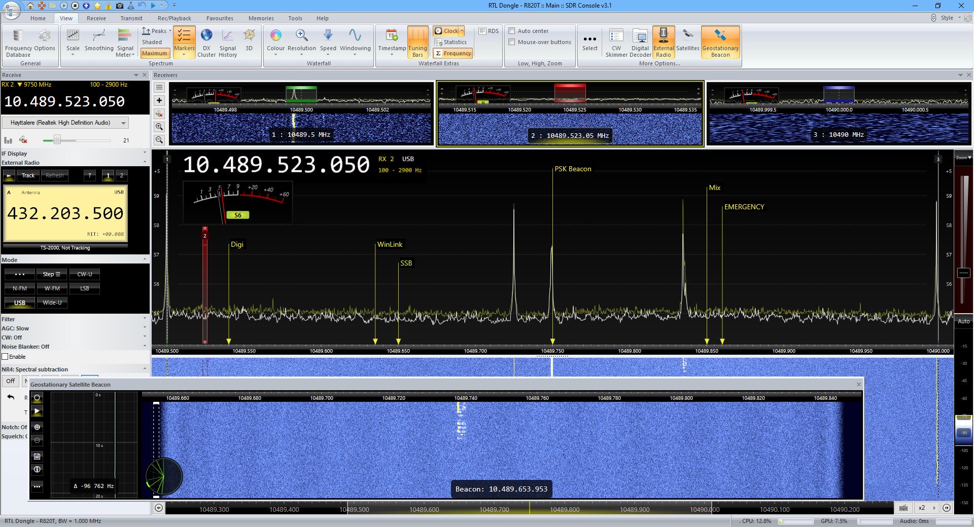

Simon & al.,
Sorry for the delayed reply.
See enclosed: today I just/almost "reached" the beacon, close enough to lock, but not entirely accurate.
I repeat my suggestion to use a unique key-click combination on the main display.
Also, for the present a more prominent status indication then "big" and "small" arrow (for locking engaged) would be appreciated
73 de LA6GH Nils
