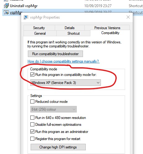

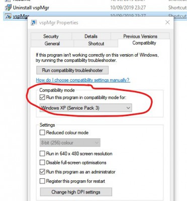

I've also just been reminded from another post elsewhere that once installed (VSP Manager), you need to go to the install location of VspMgr.exe, right click on the file and open "Properties" then "Compatibility" tab and set the correct mode. Has to be set to Windows XP mode:

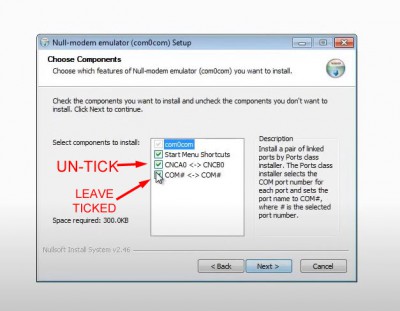

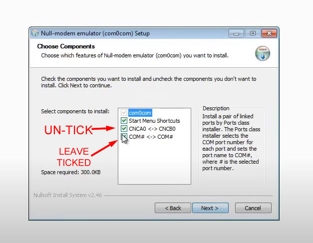

For com0com do NOT, repeat NOT, use the CNCA0 tyoe configuration. Click the "Use Ports class" tick box for both sides of the virtual com port. Then it behaves like a normal hardware com port.
Re: virtual serial ports problem
Doug, by way of illustration from Joanne's comments for com0com:
See video here:
See video here:
