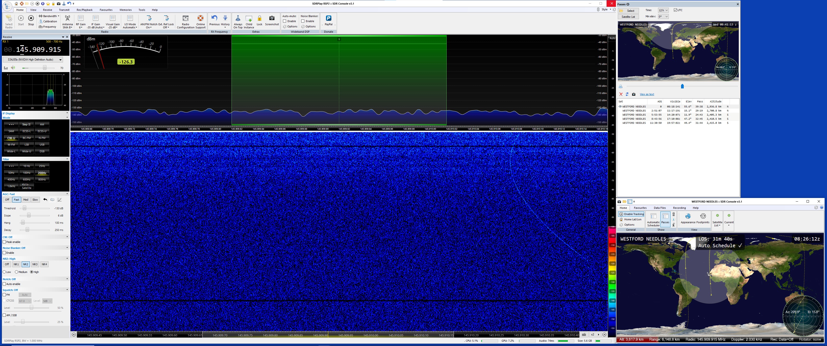

Please attach the files you are using, even if you sent them before. I really need to know exactly what you were doing just before it crashed, screenshots always help.

Interestingly I have just tried to reproduce the failure and SDR-Radio and PC seem quite happy working together.
The only change I can see is the SatelliteTrackingDefault file but that got overwritten when I restarted.
For now it seems if I select one Westford Needles as a tracking object it seems happy.
I think the problem is that something gets confused as the satellite catalog contains 34 Westford Needle objects all with different TLE but same name.
The element sets themselves appear to be unique and it is just the text label that is a multiple entry, so I wonder if you handle objects by text name rather than element number?
Pure speculation sorry, you know what you do!
