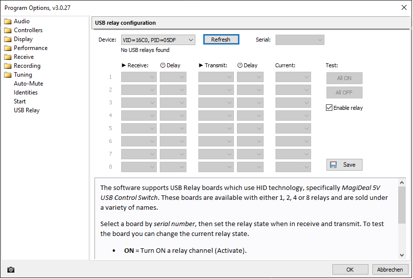

i want to use an 5V usb relay for to control a coaxrelay and the Power amplifier.
Type:
USB 5V Relay 2 -Channel Programmable Computer Control For Smart Home.
Windows detected (sorry in german) the device as:
Der Prozess zum Hinzufügen von Dienst libusb0 für Geräteinstanz-ID USB\VID_16C0&PID_05DF\5&521A615&0&10
wurde mit folgendem Status beendet: 0.
Can i use these device to control it with SDR console?
Thanks in advance
Ralf DF6VW

Yes it looks the same but i can't detect nor configure in SDR console.
In your description about relay:
Select a board by serial number, then set the relay state when in receive and transmit. To test the board you can change the current relay state:
ON = Turn ON a relay channel (Activate).
OFF = Turn OFF a relay channel (Deactivate).
I am very sorry but where can i do this?
The device is detected as DigiUSG signature Digistump LLC. Maybe windows take the wrong driver.
Greetings Ralf

Vendor ID seems to be ok but relay wont be detected.
vy Ralf

Sorry, I am not sure what more I can do. Please post a link to the relay board you bought.

He seems to be using v3.0.27. Could this be a problem?

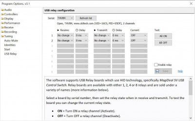

No changes with 3.1...
- Posts: 2179
Re: usb relay not detected!
Try the V3.1 beta, if this doesn't help then I can only suggest the cable or the card is defective. Does the card appear in the Windows Device Manager?
