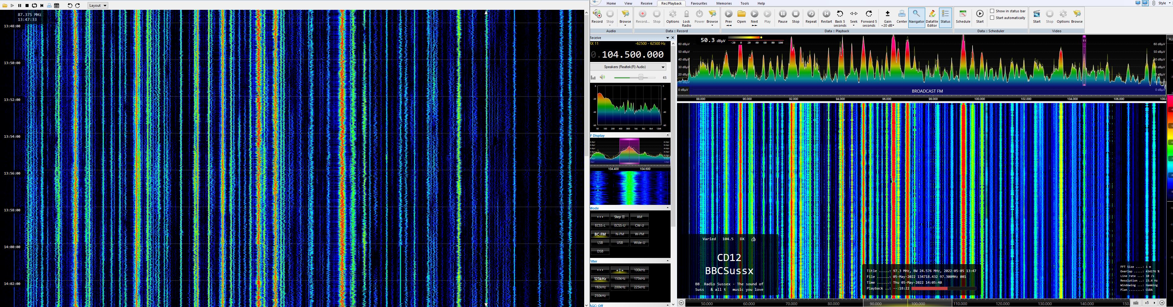

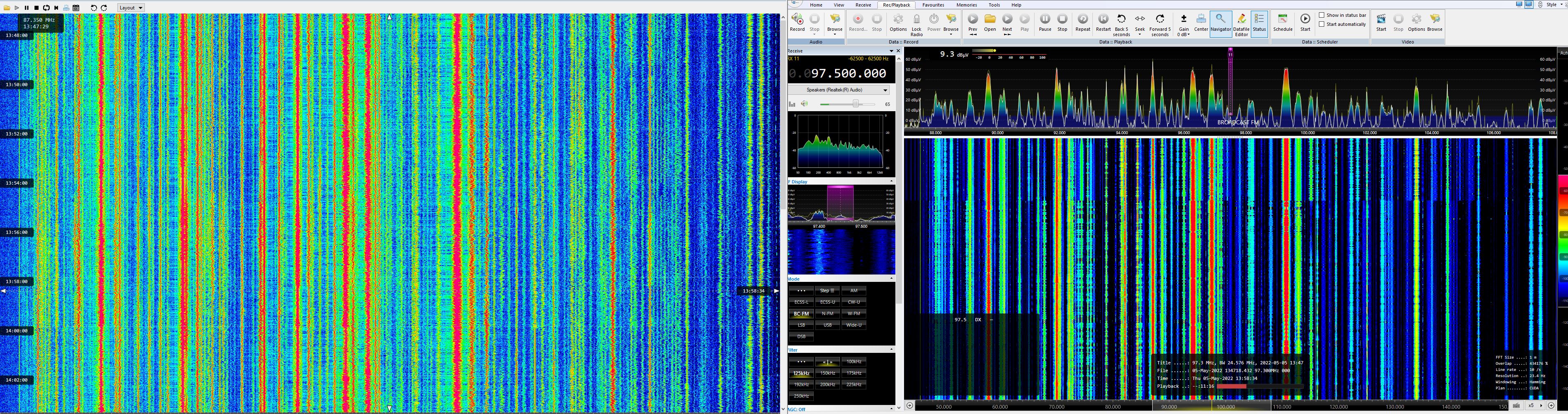

I've been playing with this feature for a couple of days getting ready for the Es season so here's my two pennies' worth. What a great addition to the programme, it makes Console so much more usable mid Es opening. I've noticed on my set up that the waterfall display values during live reception and playback are too high for the navigator waterfall making everything looked washed out. To get the 'NW' to resemble a live waterfall I shift the vertical bar on the right side up to reduce the NW display to look about right then up the data playback gain by 15dB. The easiest workaround is to have to instances of Console running, one for live/recording and one for playback.
This is how it looks 'out of the box' This after the display adjustments. I was going to mention the horizontal banding either side of strong signals but it seems Jim has covered this one and I agree that an option of a better resolution would be good.
