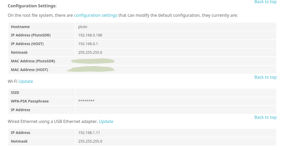

I alredy put like this : I have to tell you It works anyway ... I put 5 port switch between local Linksys switch, the main problem was NEW 0.5m RJ45/RJ45 cable (damage as new) ... I change it and ... We solved this case ...
Picture is snapshot from browser now ...

Connecting a Pluto via Ethernet is really not complicated. You have to connect the Pluto to the same lan as the pc running SDRC and make sure the pc can see and ping the Pluto.
First you connect the Pluto to your pc via usb cable and edit the config.txt file that you will find in the root of the usb drive that appears as an external usb drive in File Manager. The change to the config.txt file is simply to assign the Pluto an ip address by editing the USB_ETHERNET section:
[USB_ETHERNET]
ipaddr_eth = 192.168.1.60
netmask_eth = 255.255.255.0
The ip address you assign to the Pluto needs to be in the same subnet as your pc, in my case my pc address is 192.168.1.85 and so I chose 192.168.1.60 for the Pluto. Obviously it needs to be a free address!
After editing the config.txt you eject the usb drive and then connect via ethernet on the same lan as your pc. I have the pc and Pluto both plugged into a powered ethernet port hub.
At this point your pc should be able to ping the Pluto's ip address. If it does not get a response then there is a connectivity problem somewhere. In Simon S53K's case that was a cable fault.
Then you setup a radio definition in SDRC (home tab, select radio, definitions, add) choosing the DLL: PlutoSDR and set the address box to "ip:<the ip address you have chosen>", in the example above it would be "ip:192.168.1.60" (without the quotes).
That is all there is to do apart from the RX/TX converter to correct the displayed frequencies, I use RX: 9750.000.000 and TX: 8089.500.000.
