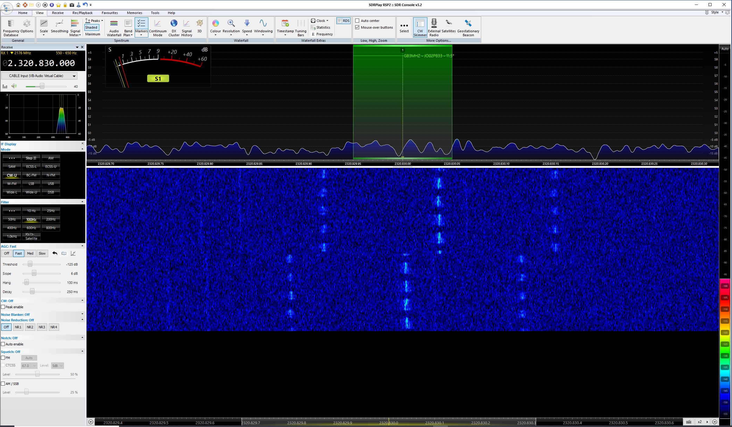

Whilst not adding much to the description a screenshot has been added to illustrate the effect (Calibration-error-SDRPlay-2022-08-03-154456.jpeg)

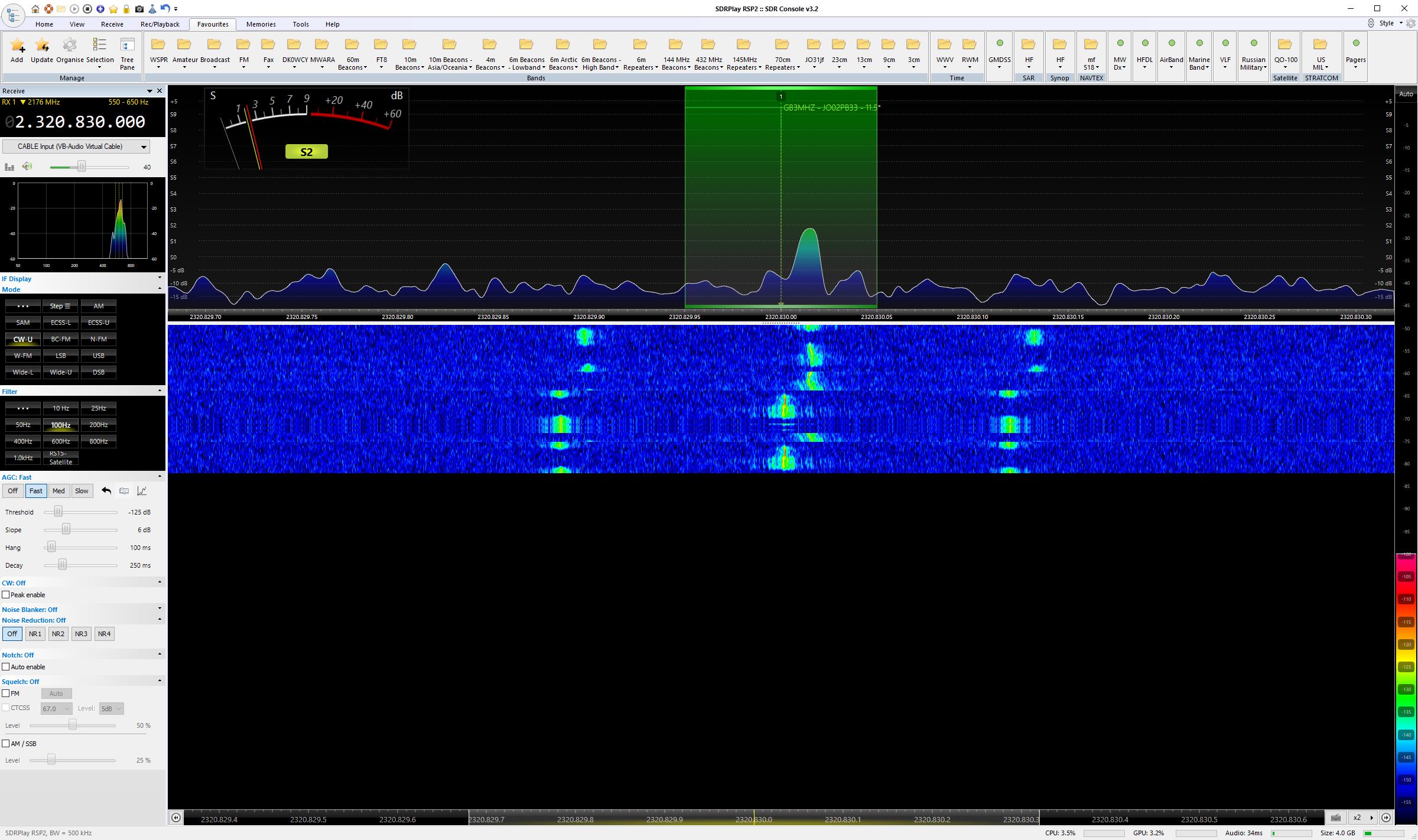

A better ilustration of the issue can be seen in the second attachment
I calibrated SDR-Console to show GB3MHZ on 2320.830MHz. This involved setting the calibration value to 0.016ppm to adjust the 37Hz error.
This was fine as can be seen in the lower half of the screen.
As soon as I pressed --><-- button to re-centre the display (although it was already centred) the 37Hz frequency error re-appeared as seen in the top part of the screen.
Ignore the other blips on the screen as these are the first order PI4 tones (that are also moved 37Hz)
This implies that the 0,.016ppm correction is not used in updating the display.
