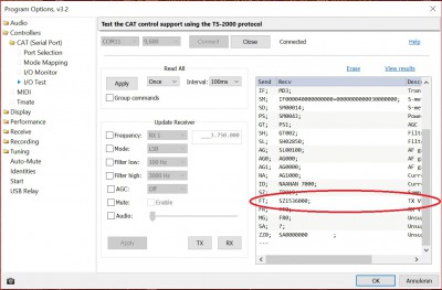

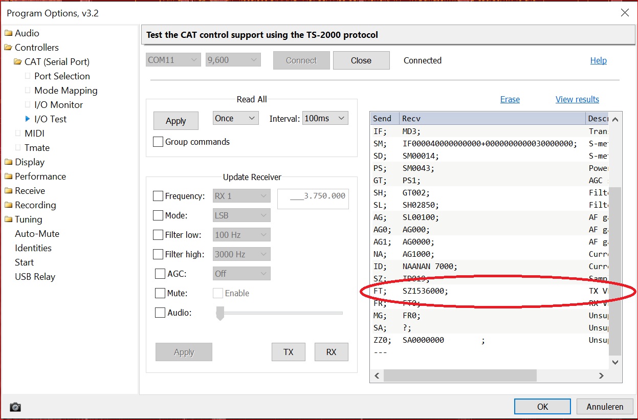

can Console send the TX frequency through CAT?
See attachment, is this usefull for you?
regards, Leon
