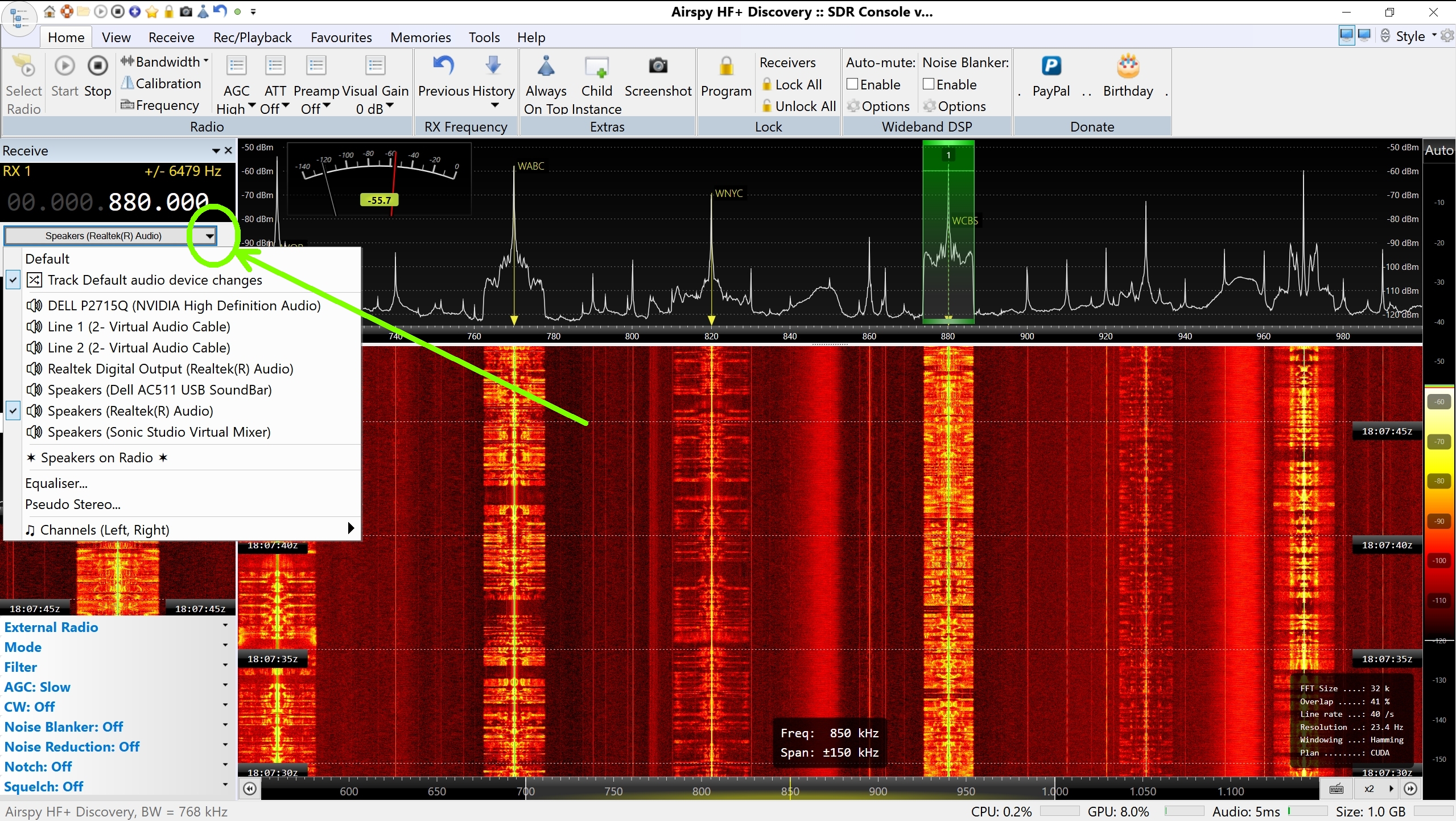

Hi Guenter,
You can select the output the SDR Console uses by using the audio drop down menu near the top left (see attached).
If you use your virtual audio cable (for easypal) and also run an Audio Repeater, you should have both.
Barry
WB2ZXJ

To hear audio from SDRC when audio output from SDRC is sent to Virtual Cable, you need to "listen" to it in Windows "Audio Devices" panel.
Follow these instructions:
In the drop-down audio output selector shown by Barry in his earlier post, on the SDRC Audio RX DSP panel, select this to be your VAC.
Now you need to "listen" to the VAC input on your PC speakers/headphones by tick-box setting in Windows Audio Devices:
Press "Windows" key and then type "Run" to bring up the Run command. Now into the Run command type "mmsys.cpl" (without the exclamation marks) and press return then. The "Audio Devices" window should come up.
Now, in the "Recording" tab, select properties for "VAC Line 1" (or whatever VAC it is you want to use), then tick "Listen to this Device" in "Listen" tab. Now you can just leave VAC permanently selected in SDR Console audio out selector for sending to external programs, but simultaneously listen to it on your speakers.
Good luck
