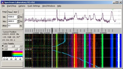

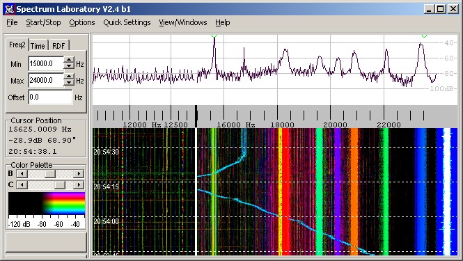

Not at all the same display, but the following caught my imagination some time back:
https://www.qsl.net/dl4yhf/speclab/colourdf.htm
