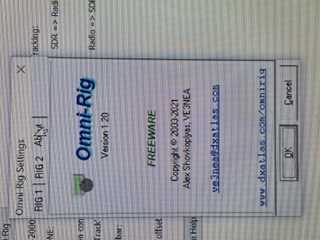

Are you in fact using the "External Radio" option for this? If so, what version of Omnirig are you using? As far as I know SDR Console needs Omnirig 1.2, not version 2.1.

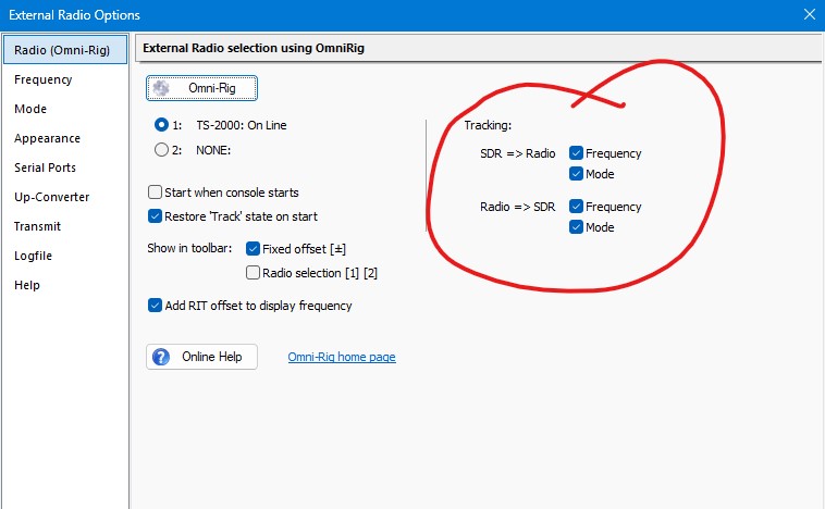

Also check these tick boxes (see attachment) in the External Radio settings (question mark top right of External Radio panel. Have you got the boxes checked for both directions?

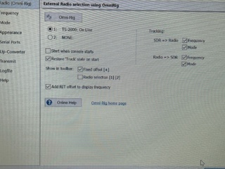

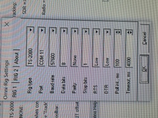

I can confirm I'm using OmniRig 1.2 with the exact same settings in your attachment.

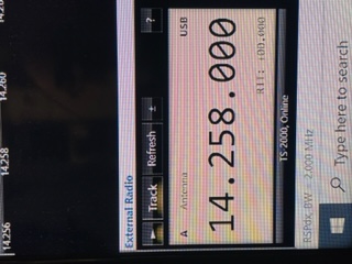

Also the External Radio box is working and shows connected to OmniRig TS-2000 Online.

Actually a Com port conflict was the first thing that came to mind, but thought we would check the external radio settings first. Seem OK.
Please excuse me if I state what you already know (and in fact I hope my own understanding is correct) but for every application you need a dedicated pair of ports, one to SDRC and one to the application. This pair ports can't be shared with other applications (at least that's both my understanding and also my experience). For myself I add virtual serial port pairs using VSP Manager from K5FR. I keep the odd numbered ones for SDRC and the even number ports for the application. So for example, for WSJT-X I use Com13 for SDRC and Com14 for WSJT-X. For VARA I have Com5 for SDRC and Com6 for VARA.
