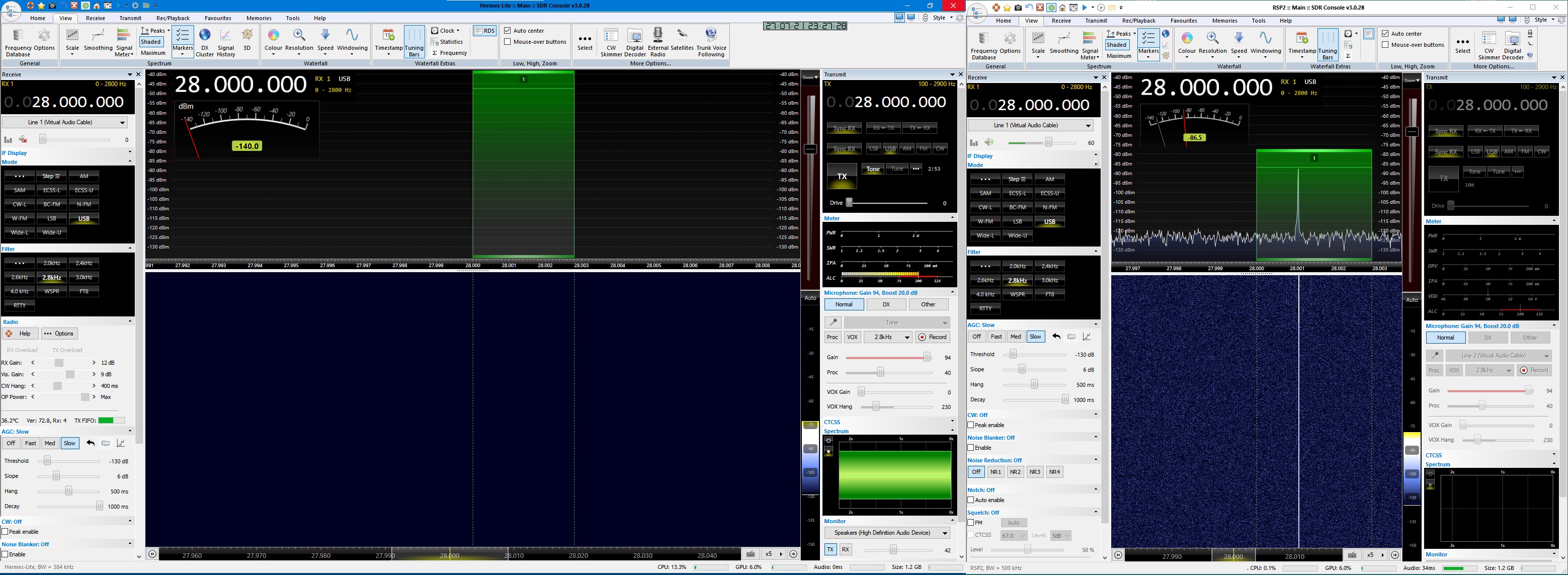

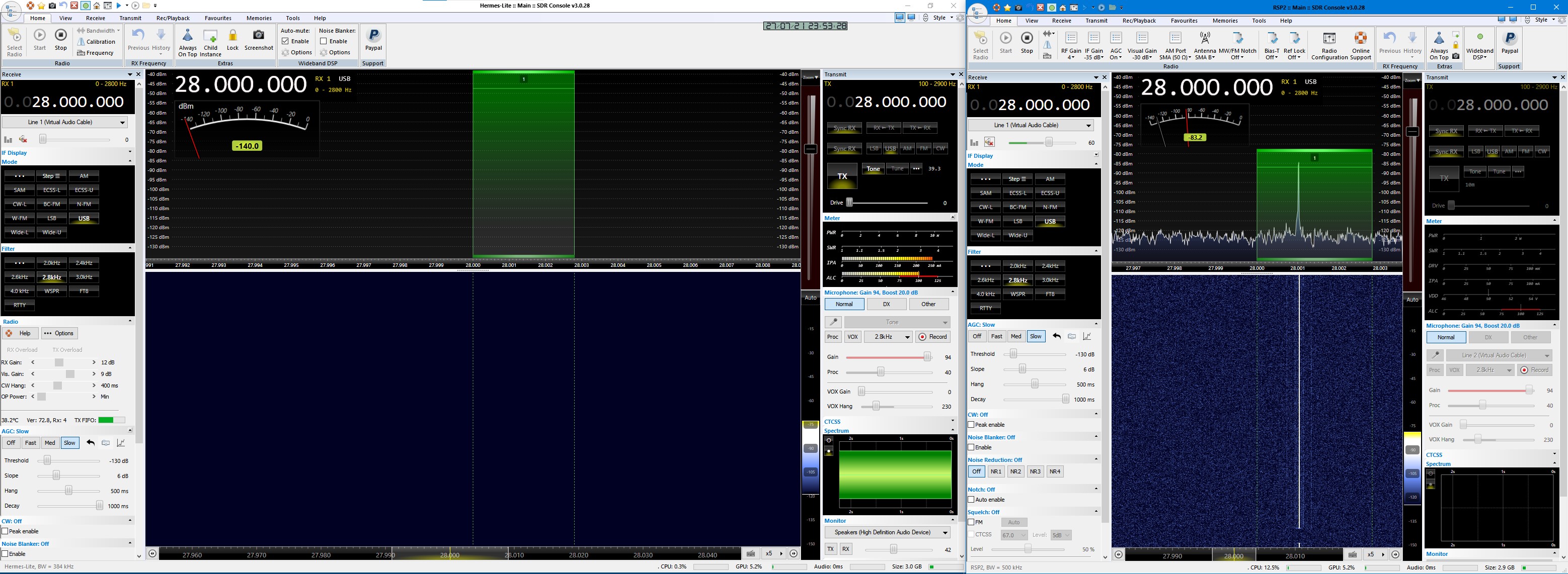

Re: HL2 - Output/Drive control functions with PA disabled
#20
OK Simon. So herewith 4 screenshots.
Each screenshot shows, on the left, HL2 in TX with tone applied and SDRC tone generator set to single tone, 1 kHz tone. On right of screen is the receiver (RSP2Pro with no antenna attached to prevent front end overload).
For every shot I used the same small tail of wire connected to the relevant output socket on the HL2 for each mode, so socket RF1 for screenshots 1 & 2 (PA Disabled) and RF2 (Ant/PA output) for screenshots 3 & 4 (PA Enabled). In this way the RX S-meter readings should consistently represent true power out from the HL2 (relative to each other for each picture).
So what I found surprised me. All was not what I had previously guessed, namely I discovered there is definitely power out of even the PA/Antenna socket when the PA is enabled, and Drive is zero. It's just that it's small enough for me to have never noticed it when connected to an antenna. So as an experiment, I connected the HL2 Antenna socket (RF2) to my transverter input, and with TX DSP control set to Zero, and in TX mode, I applied the 1KHz tone. Boom....... Transverter transmitted flat out (designed to need about 20dBm drive maximum).
Be totally clear. This is NOT carrier. You can see very clearly from the screenshots it's the 1 KHz tone that's being transmitted and appearing bang on 28.001 MHz.
So what I discovered is it's not just a Low Power mode (PA disabled) issue. It's both with PA either disabled OR enabled that there is power out from the HL2 with the TX DSP Drive control set to Zero.
Will leave it with you. Let me know if you need anything else to diagnose. I actually wonder if it might be worth seeing if anyone sees the same with other rigs or if the issue is strictly limited to the HL2? It's such low power output with the Drive control at zero that it would easily be missed in normal operation.
