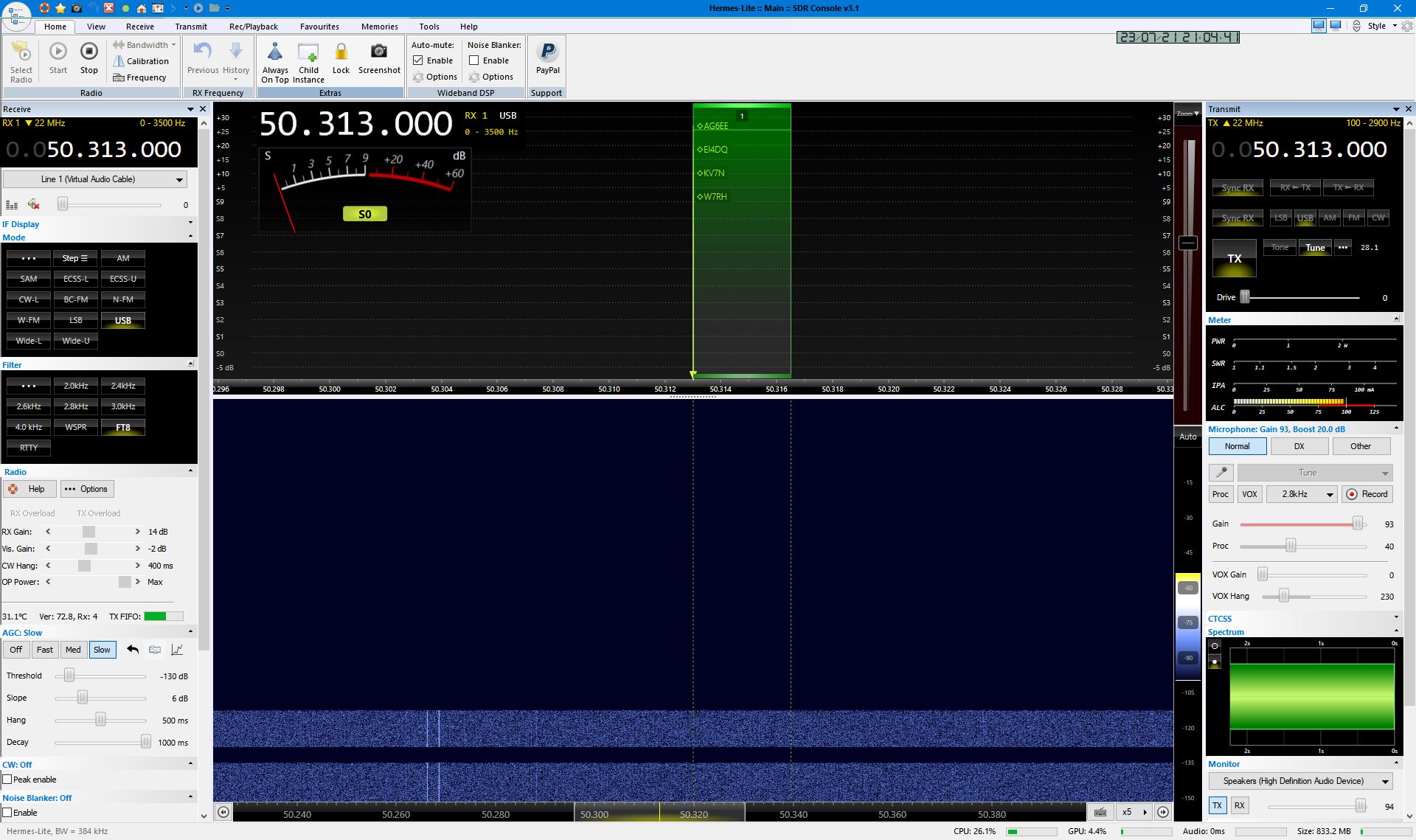

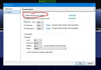

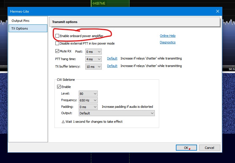

Hi Simon. Thanks for reply. Screenshots attached. One shows the PA disabled in the HL2 Radio settings. In the main screenshot you can see I am in "Tune" mode, with the ALC meter confirming audio tone present. You can see in the TX DSP panel the "Drive" control is set to zero.
"OP Power" slider in the TX "Radio" panel on left is set to "Max".

In this state I see about 7W at the output of the transverter. But what's odd is when I increase "Drive" control to 100 in the TX DSP panel, the power at output of transverter goes up again to full 10W output. In the low power mode I didn't think the Drive control would do anything because I assumed IQ out level is controlled by the Radio "OP Power" slider? I thought Drive control would only affect PA drive with PA enabled. Yet they seem to interact in some way at the low power RF1 output with the PA disabled?

Not so. The PA is disabled from within SDRC. See my screenshots in the third post in this thread. But if what Simon says is correct and the Drive control controls the IQ output, then when Drive set at zero then the output should indeed be zero (I would have thought?) and this should be exactly the same whether the PA is enabled or not surely? If drive control on any transmitter is set to zero I would not expect any output regardless of what type of TX it is. This is what I see with PA enabled. Setting of zero on the TX DSP Drive slider gives 0 Watts output from the PA. All good. It's with PA disabled when it all goes odd.
