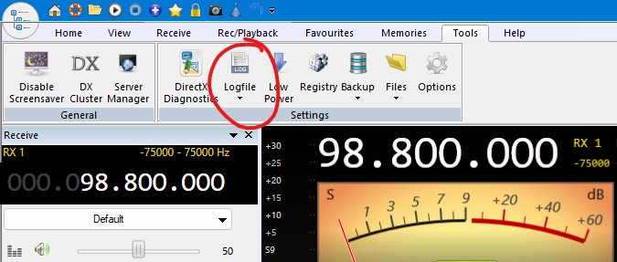

Tools Tab. I don't know for sure it the log file has the data Simon needs for this particular issue but you can give it a go. Suggest erase it, then start SDRC and dongle then try a few frequency changes then save the log file. I doubt if Simon will want to get involved in "one to one" fixing but he may be able to see something untoward.pirpy wrote: Tue Jan 31, 2023 9:23 pm Where is the log, I can paste the log here.

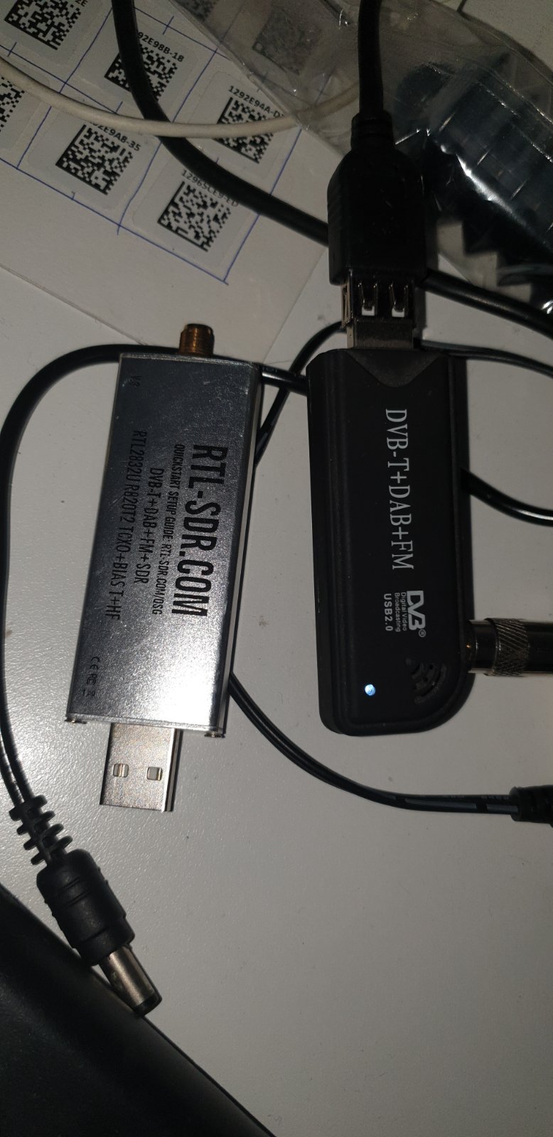

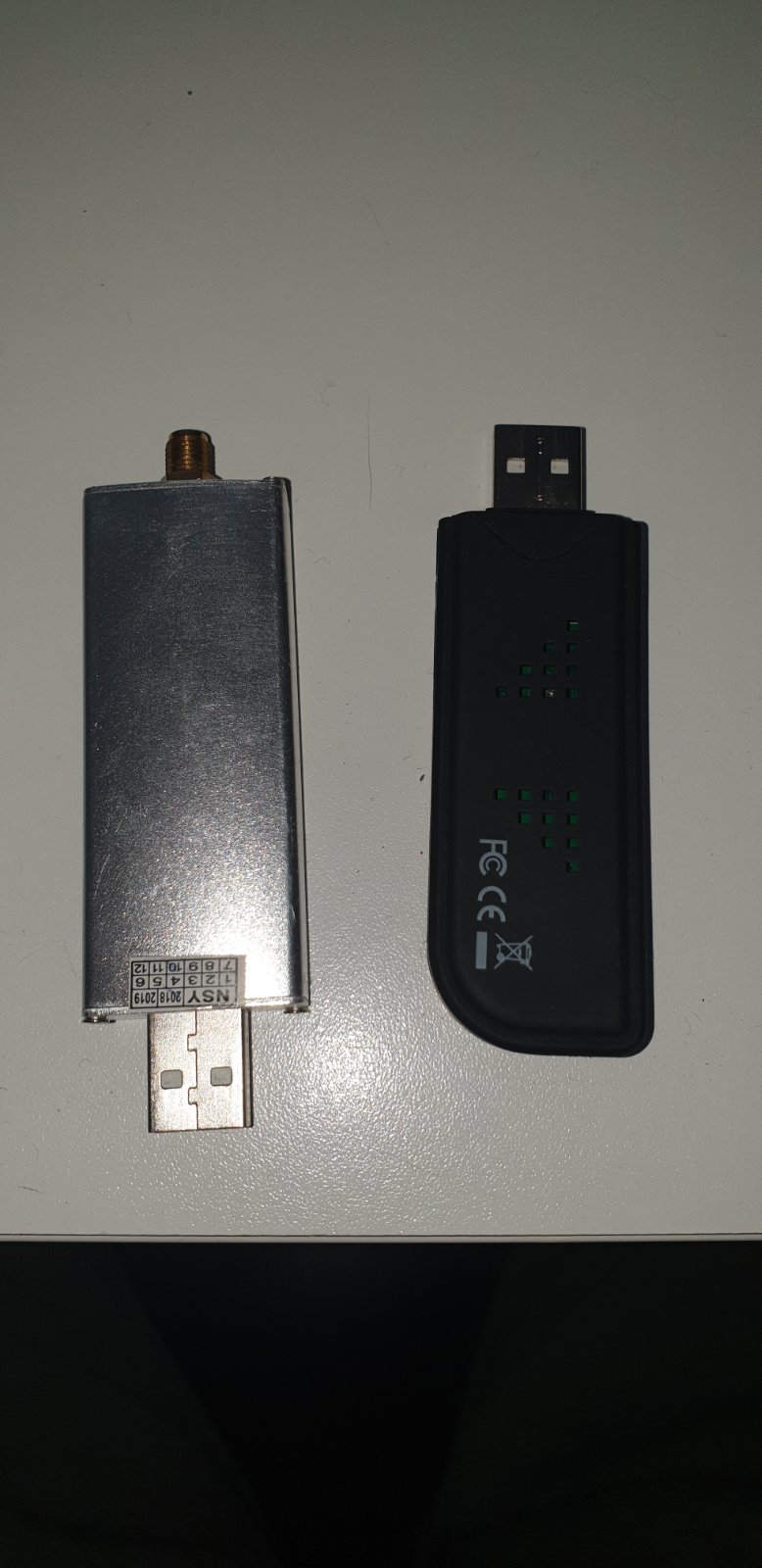

Just out of a sense of curiosity could you take a picture of both sides of one of the dongles? That might help sort it out.
