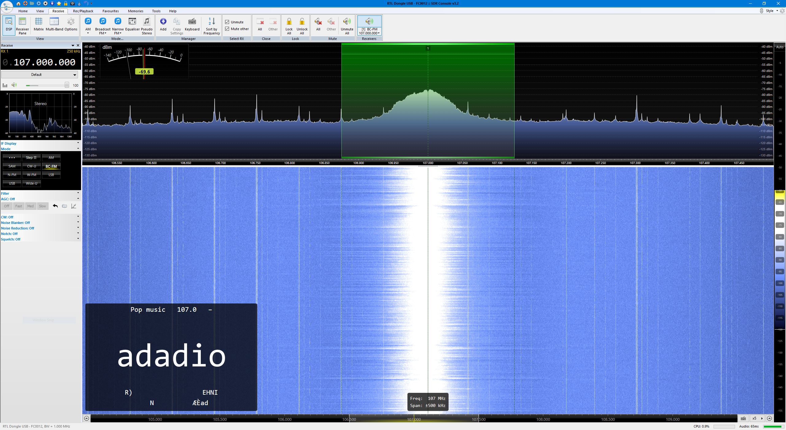

Hello
I'm having problems with my new windows 10 computer.
the sdr console frequency is fixed and cannot be changed, I can punch in new frequency but the spectrum stay's the same .
I can zoom in and tune in to stations on the frequency span that the console started with.
If I want a new frequency span I have to punch in new frequency then stop and start the radio or restart the console.
It seem's that the only time the sdr console can tune the frequency is on start.
I have reinstall the driver many times with zadig but always the same result.
I get the same result with 3 diferent dongles.
on the same computer and old windows 10 partition everithing work's fine.
Please help, I dont want to reinstall windows for this.

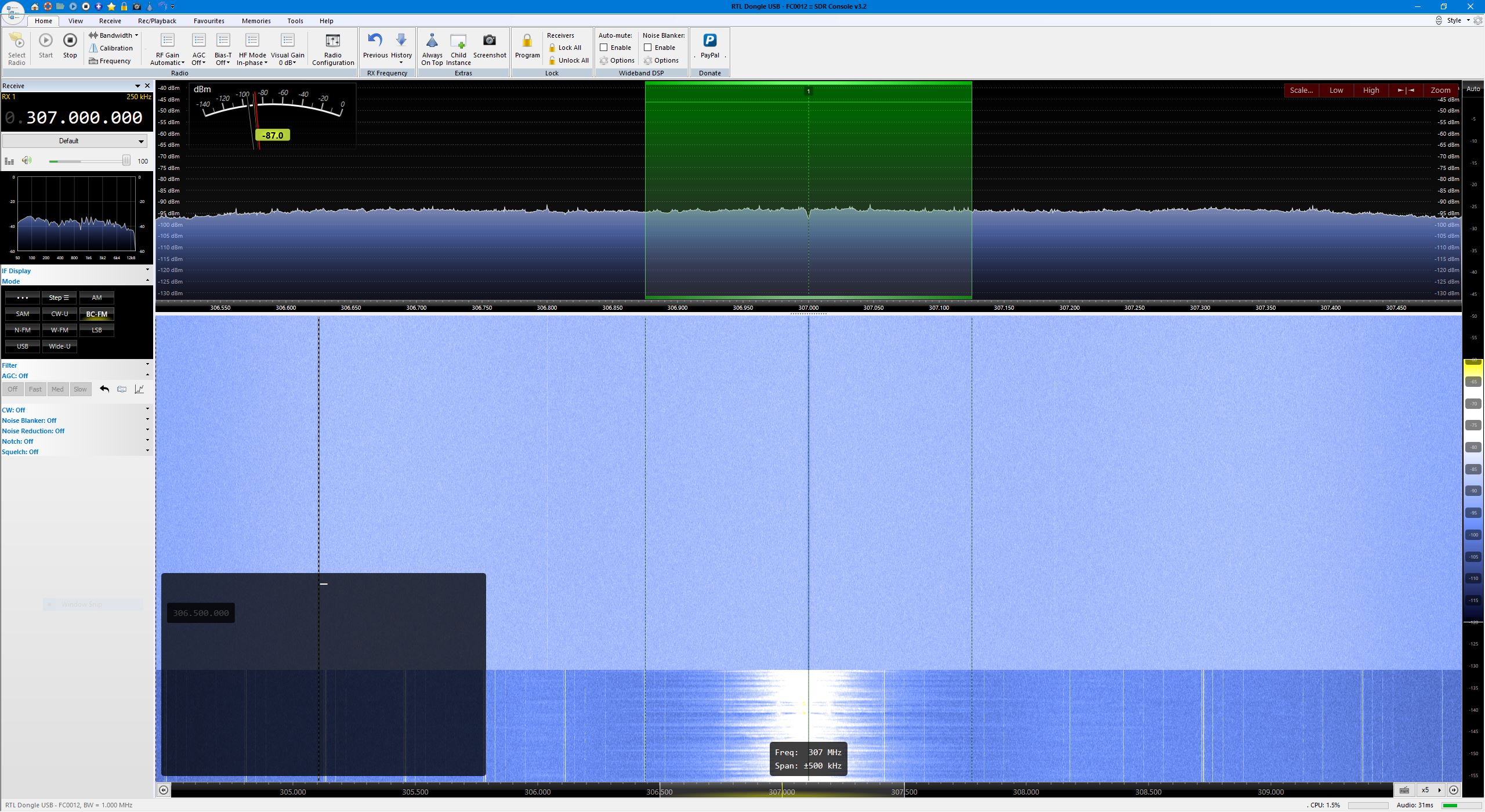

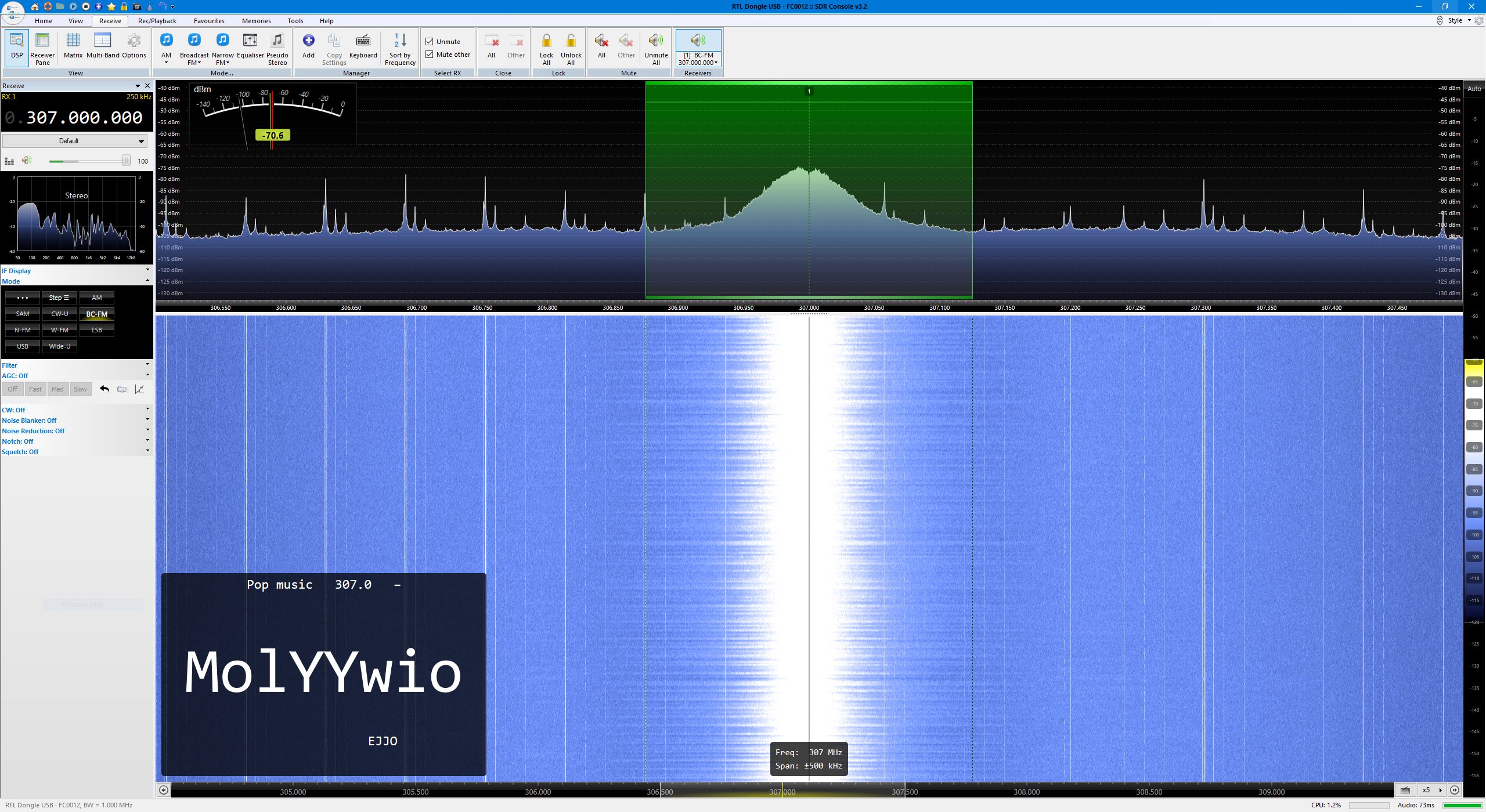

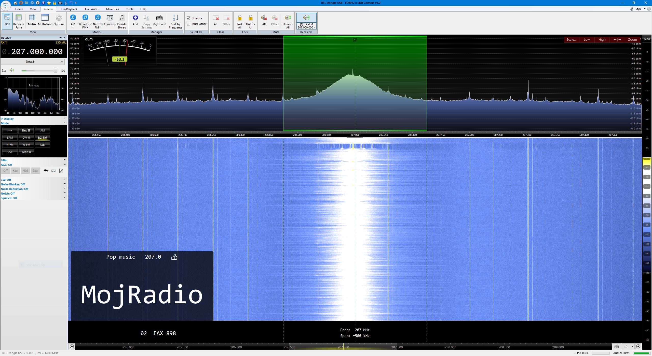

the real frequency of local radio
now I change the frequency to 207 MHz but the radio is still playing..
and at 307MHz or any other frequency
the only way to change the frequency for real I have to stop and start the radio.
after restart Im listenning the real 307 MHz
