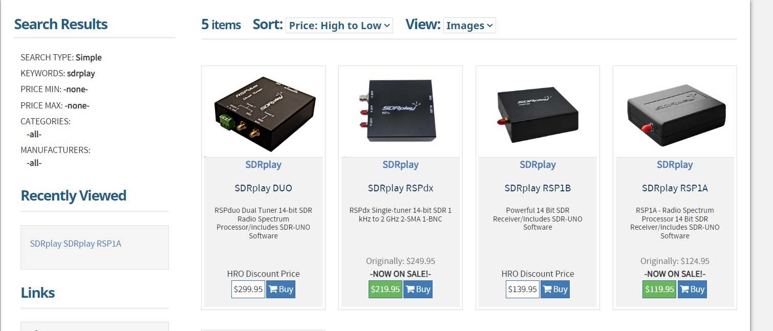

Thanks, Max. I didn't see that in the states our HRO stores.

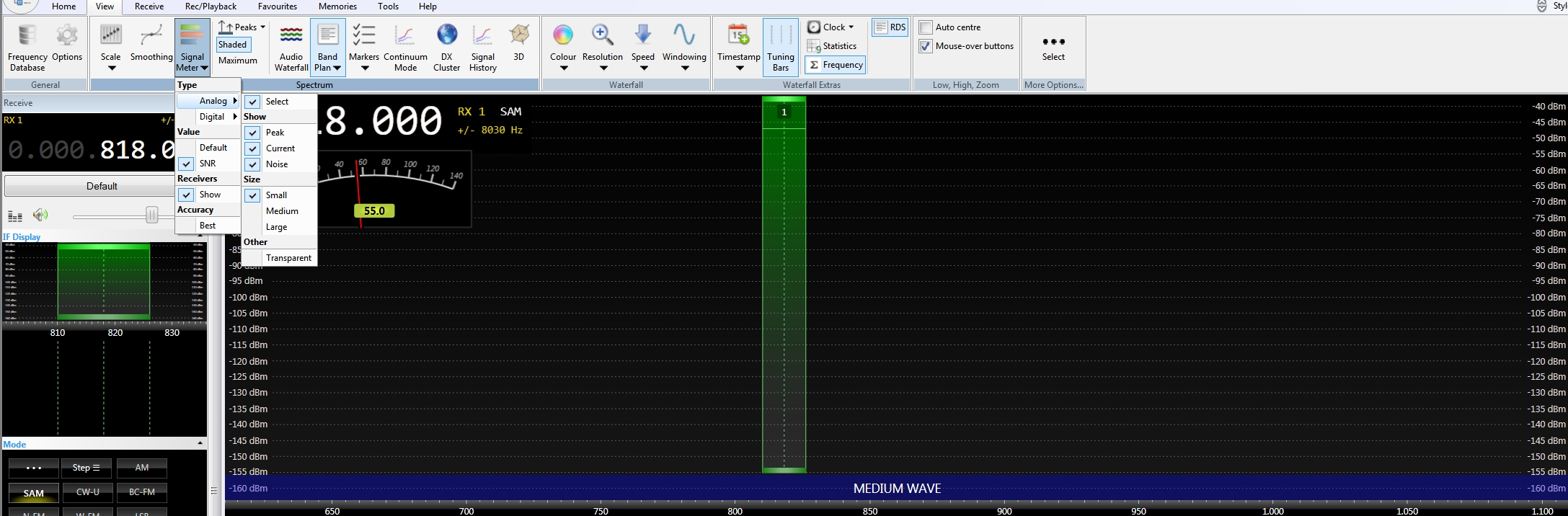

Back on topic: How do I get this S meter vs the black one?
https://scontent-sjc3-1.xx.fbcdn.net/v/ ... e=65C290F1

steelgtr wrote: Fri Feb 02, 2024 3:35 pm Thanks, Max. I didn't see that in the states our HRO stores.
Airspy HF+ Discovery:
https://airspy.com/airspy-hf-discovery/
Just be aware of lower sampling bandwidth (912kHz) compared to the SDR Play devices, but if you are concentrating on LF/MF/HF listening, especially if you are a serious DXer one band at a time then this is pretty much unsurpassed at the price.
RSPdx more of an "allrounder" which also gives listening on VHF/UHF. I believe it's also reasonable on the AM bands unlike some of their other models. I am sure it will be perfectly OK for you unless you have a very strong AM broadcast station near you.

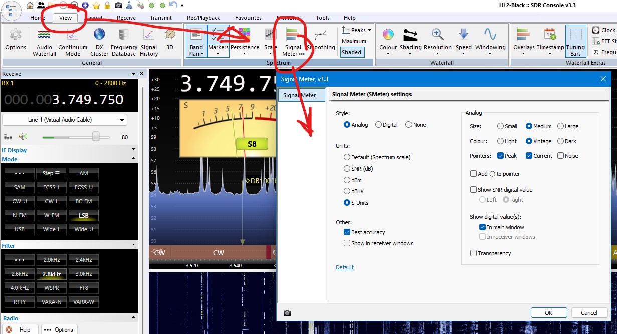

See picture:

I'm running 3.2 so maybe that's why I don't have that.
bob
Re: Layout Help
#18
steelgtr wrote: Fri Feb 02, 2024 11:12 pm
bob
Ah, explains much. TBH I would never bother with the "Release" version of SDRC. Always use the latest Beta:
No need to uninstall anything. Just install over the top of 3.2.
The Beta that is posted on the website (linked above) has always been thoroughly tested by the Test Team for usually several weeks before it's posted for download. I can assure you it's not only totally safe to run but also highly recommended because there are actually bug fixes and many other features that are not in 3.2.
Good luck.
