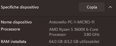

Oh, and what is your computer and CPU/Memory/etc? It LOOKS like it's something fairly new with plenty of CPU. The information might lead to something.
