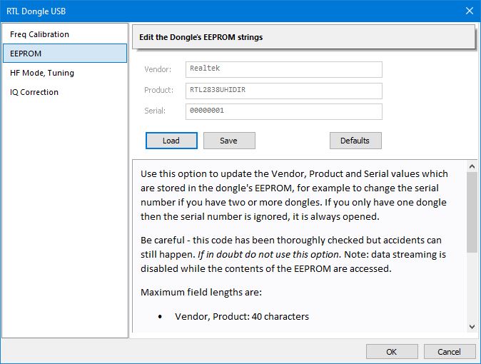

With only that dongle plugged in let's change it's serial number. On the home menu you should find "Radio Configuration". Select that. In the dialog that comes up select "EEPROM".
** Oops - Ah Simon, what is the "load" button supposed to do? **
Well, the "Default" button seems to read what is already in the dongle. So you can select "Default" and then on the third line change the "serial number". That can, literally, be a sequence of any 8 bit characters as you want - no unicode even though it's saved internally as unicode. Go figure. For example I have one named "15" and another "RTLSDR 2". Keep it fairly short. 20 characters is safe. 80 might not be.

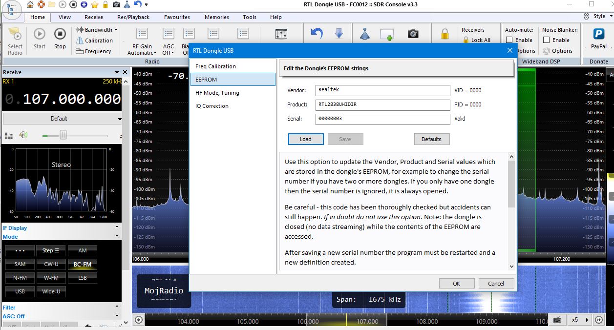

On this dialog:
I get this error when I press "Load".
EEPROM error.png (3.83 KiB) Viewed 2944 times
On the other hand I have confirmed that the "Default" button does read the dongle contents for editing.

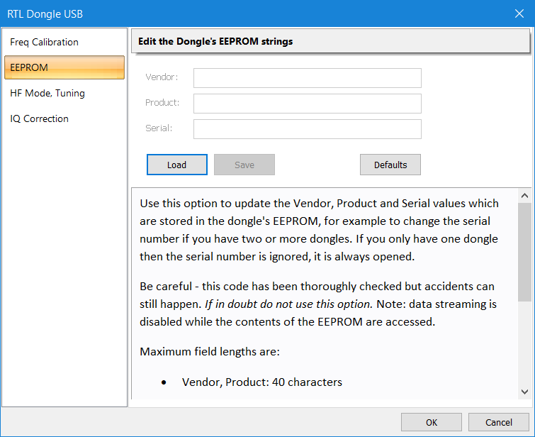

the load button say EEPROM not found
the Default button fill out the lines butt I cannot change anything, its gray out

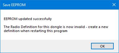

So I can change the serial number in eeprom but both radios are stil not working together, in radio definitions is still only serial number *001 found
and the frequency tunning still does not work.
