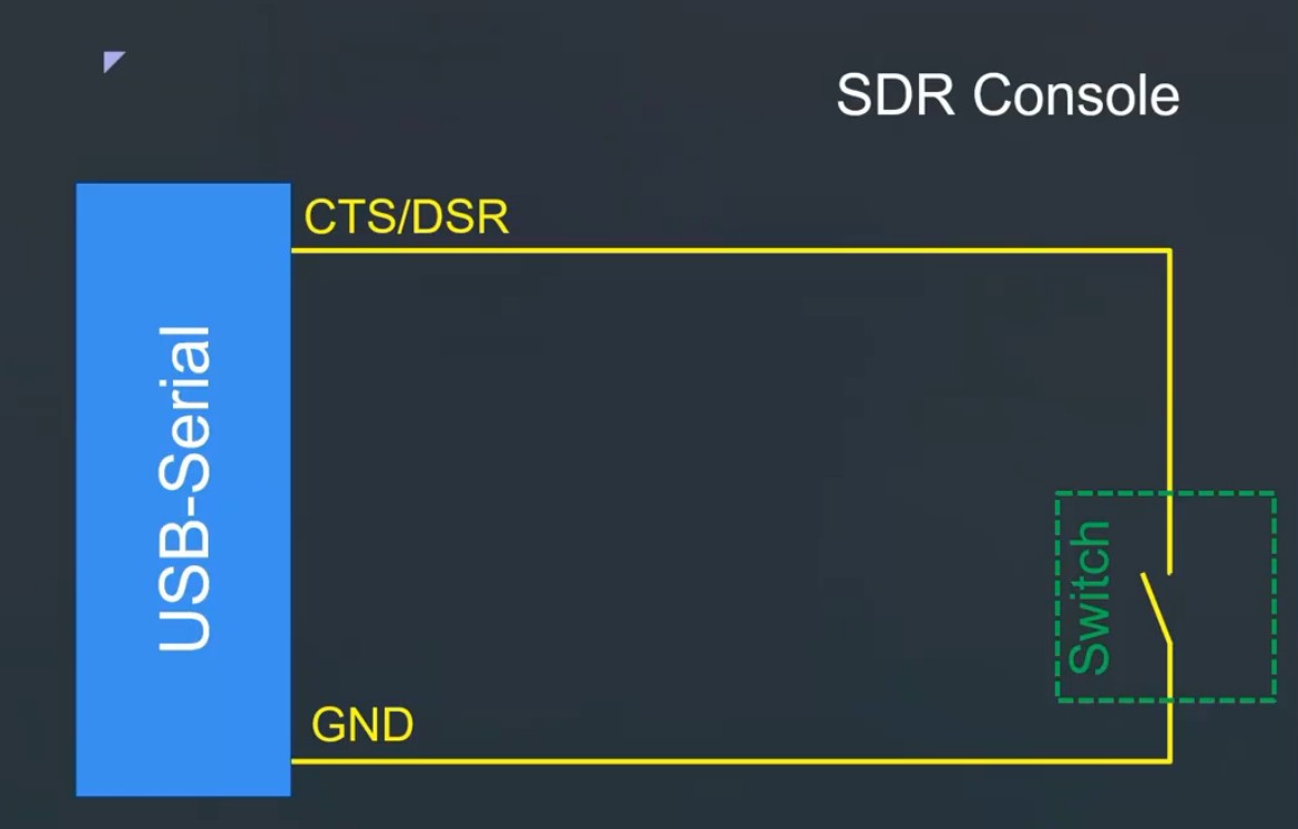

FTDI Serial adapter (any) like this/Adattatore seriale FTDI (qualsiasi) come questo:
https://www.ebay.co.uk/itm/365943351983
See very simple circuit like attached picture/Guarda il circuito molto semplice come nell'immagine allegata

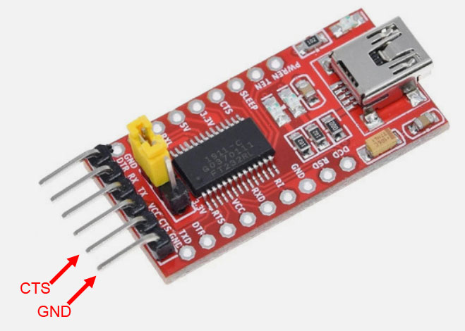

OK I am now very confused. I thought what you wanted was to connect PTT switch to SDRC to be able to make SDRC enter transmit mode with an external switch like a footswitch for example when using the Elad FDM-Duo. That is what this circuit was for. In this case use switch to ground the CTS, not DTR!
None of this is needed for the Hermes Lite 2 which has it's own PTT on the rig.
Is this what you want (put SDRC in to TX mode with FDM Duo) or are you trying to do something else?

As for my previous reply, connect switch to GND and CTS (not DTR)
Then connect USB to the PC (not to the Elad)
Job done!

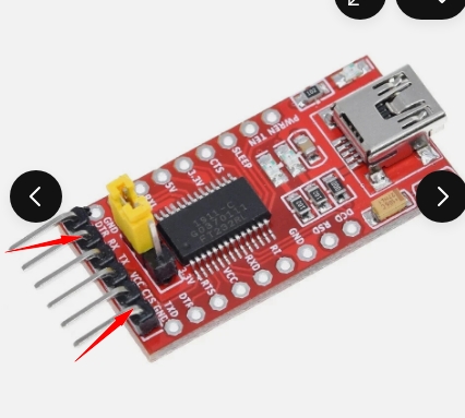

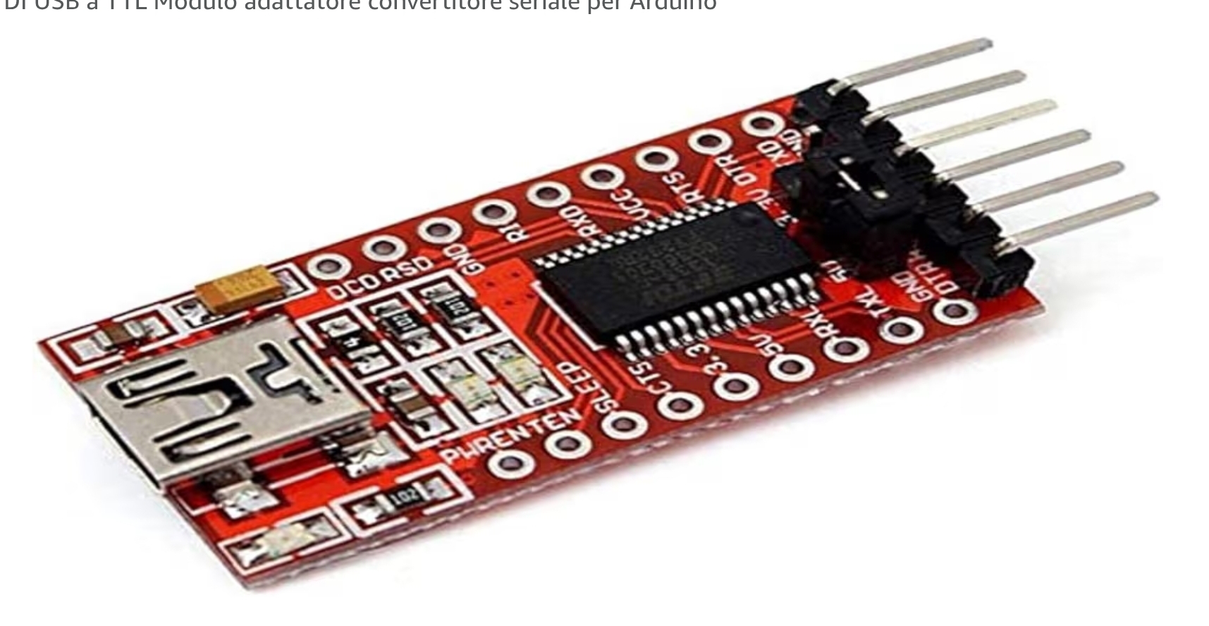

I took this one, it cost less and it was in Italy
But this one DOESN'T HAVE A CLEAN CONTACT, it has 5 volts! If I get the pin wrong, I'll burn the battery... are you sure about the contacts? Thanks
