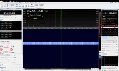

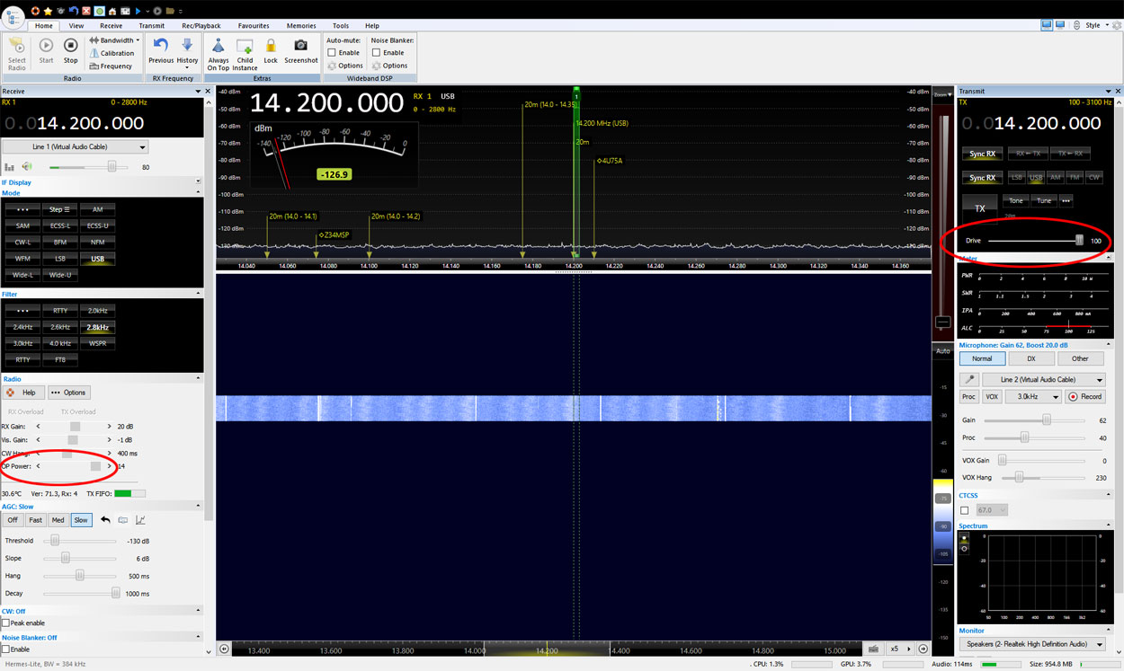

2) Ans: Not sure about this one. There are two places to control Drive in HL2 on SDRC. Simon best placed to answer this one perhaps. Simon?
3) Where is PA setting in SDRC? In HPSDR, this value determines the drive level.

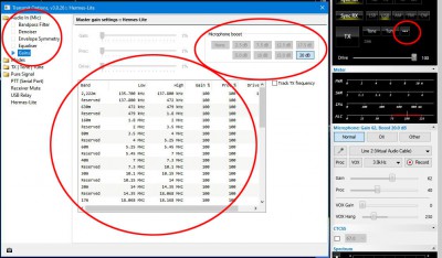

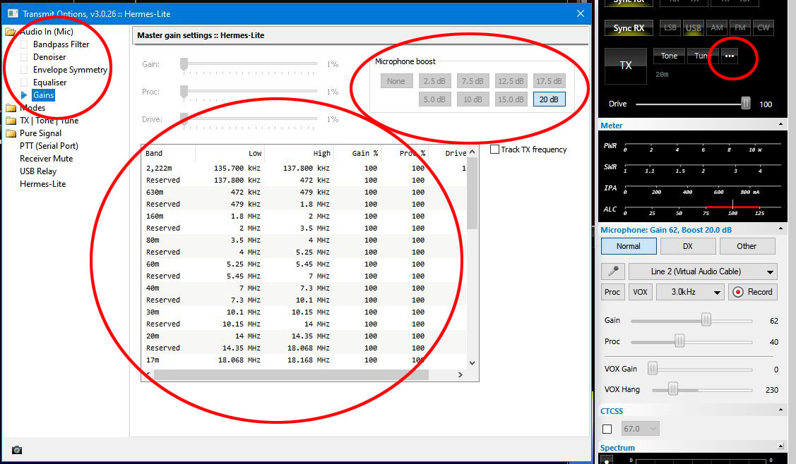

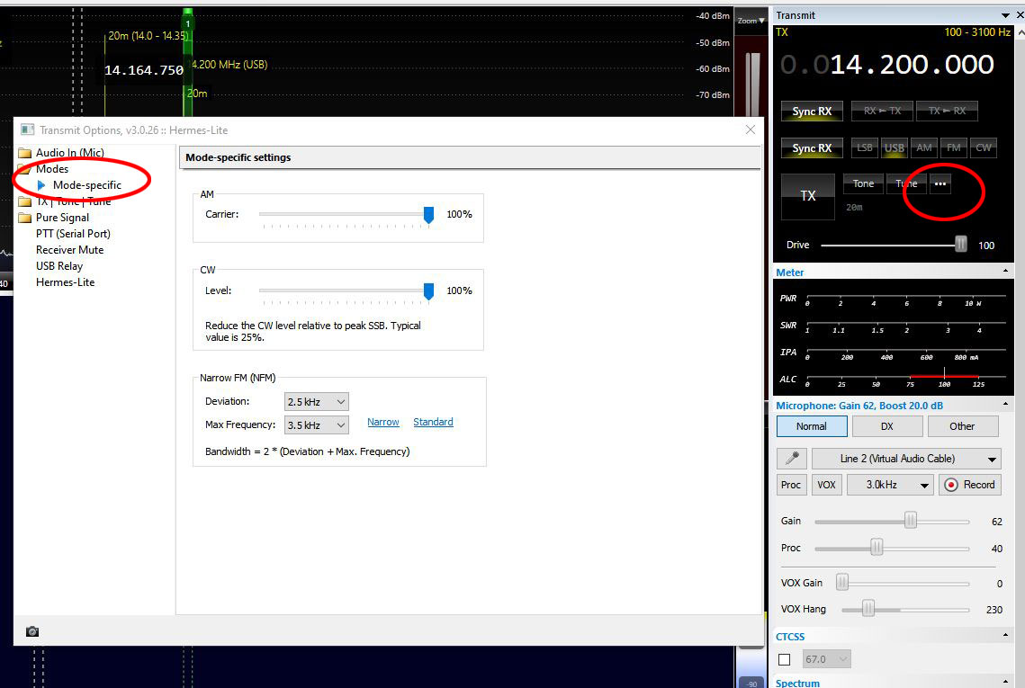

3) Ans: As above (see attachment). Also in Settings (see attachment).
4) Audio gain from MIC is too low even I put Mic Gain maximum, therefore not power from PA in SSB.
4) I have asked Simon about this before and he has improved it considerably in latest builds. Are you using latest kit? 3.0.25? Do you have Mic Boost enabled? (see attachment). Did you check "Gains" settings (see attachment).
