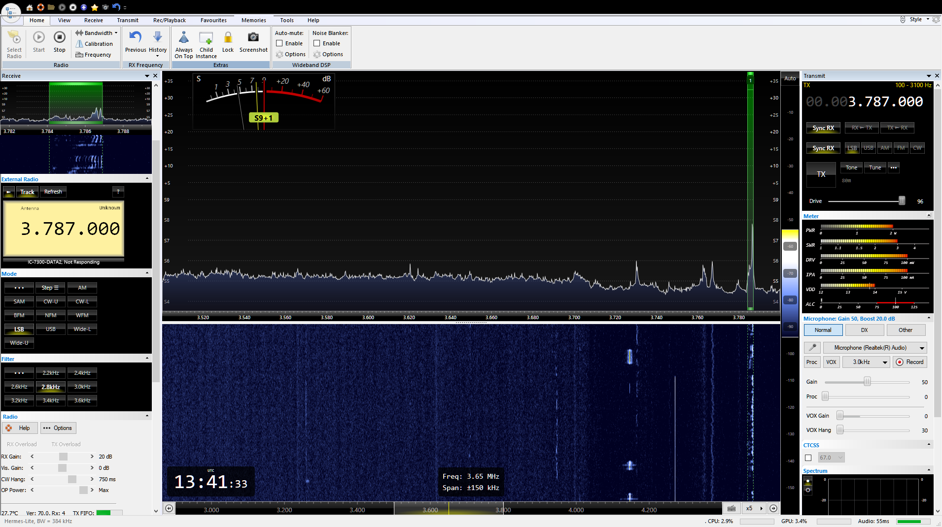

Thanks for the quick reply, Simon. I'll try to post a couple of screenshots. One is on receive the other is in tx mode.

Only thing I notice on your screenshot is you have the external radio panel there. I wonder if that is something to do with it? I would not expect that there if you are running HL2 "clean"? The very first thing I would do is disable "External Radio" option on the ribbon bar then try again.

Max, thanks for the suggestion to turn off the external radio...it worked! Also thanks for the link to the .rbf file: I shall upload it shortly.
