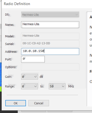

Ok, I guess it's the search that fails since it's in another sub-net. When I place it in the 192.168.. network, SDRC finds it with search. Then I move the HL2 to the 10.0.. network and change the IP address SDRC. Then everything seems to function :) . So an option like Ingolf suggested in
viewtopic.php?f=53&t=503
would it be possible ?
73/Bengt

Simon G4ELI wrote: Fri Dec 11, 2020 2:18 pm Try the kit I posted today.
Why is your subnet 10.0.x.x - what's the reason for this? If 10.0.x.x. is a standard then I do understand that it should be searched as a default.
Ok, will check the new kit. The reason for having a "2nd" network like the 10.0.x.x is that it's a shared common network with some other friends also interested in SDRs etc. I have access to the network directly also but it's convenient to access it from my home network where I have most of my connected things already. And from a security point of view I have the firewall etc.
So this is probably not a normal setup...
