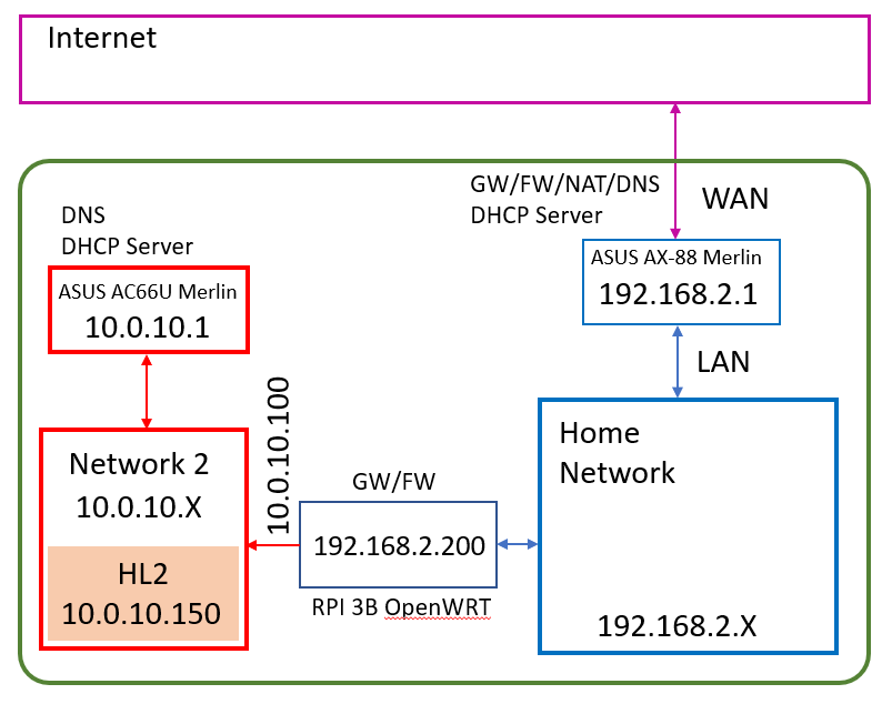

Ok, maybe it's something with the firewall but still SparkSDR can find the HL2. Different FW rules ? I did a picture to clarify my network. And there is a static route in the AX-88 router to Network 2 GW for 10.0.10.0/24.

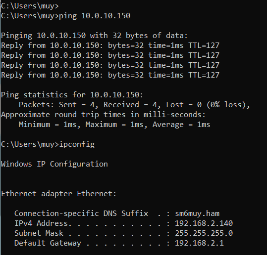

Open a command prompt.
Type "ping 10.0.10.150" followed by enter.
You should see something like:
===8<---
Pinging 10.0.10.150 with 32 bytes of data:
Reply from 10.0.10.150: bytes=32 time<1ms TTL=64
Ping statistics for 10.0.10.150:
Packets: Sent = 4, Received = 4, Lost = 0 (0% loss),
Approximate round trip times in milli-seconds:
Minimum = 0ms, Maximum = 0ms, Average = 0ms
===8<---
I suspect you will see that. However, if not we really need to dig deeply into the networking involved. It will be messy. Meanwhile, make very sure NOTHING else is using your HL2.
