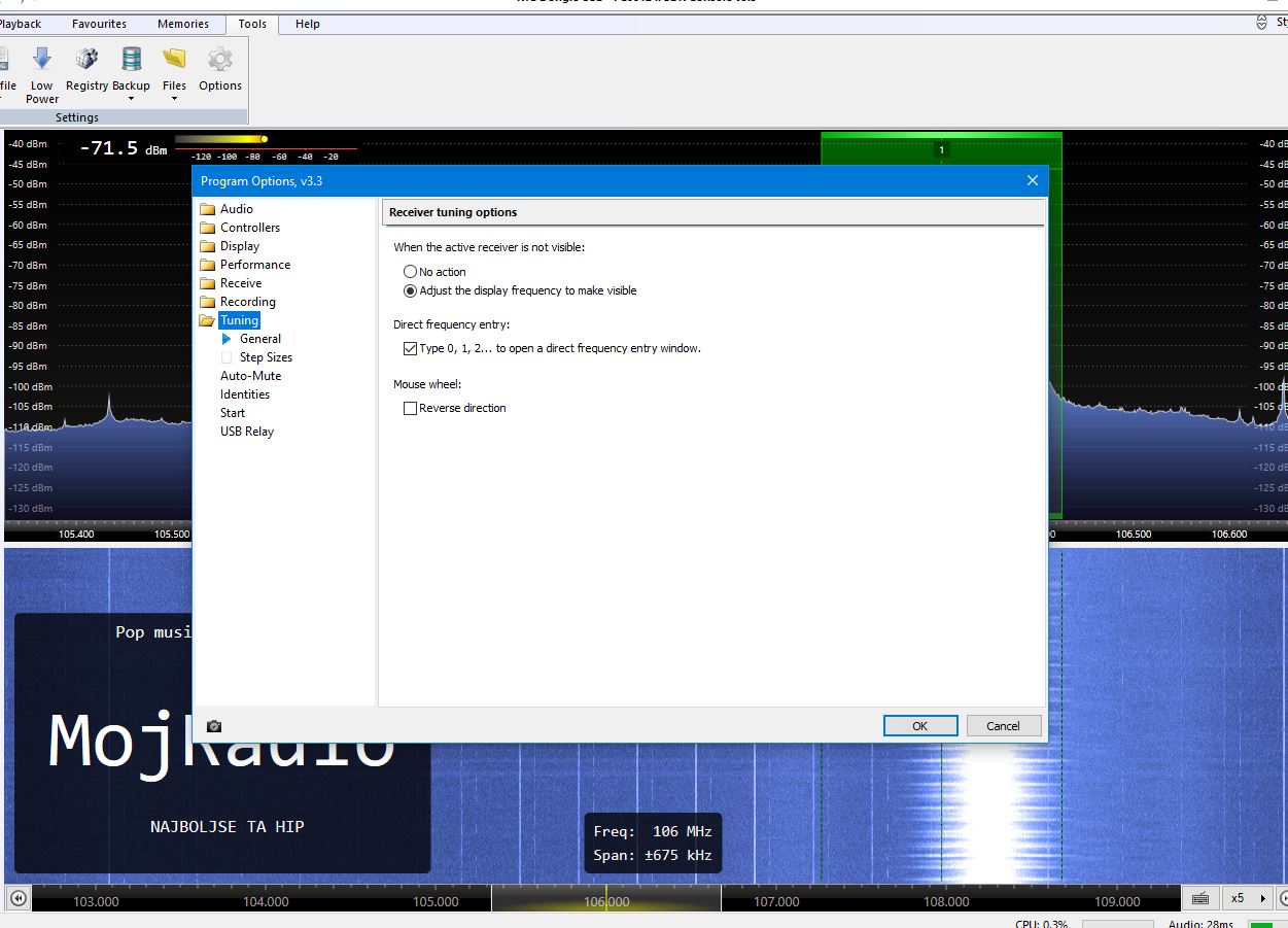

I suspect you are looking for a behavior I find nonsensical, recenter the front end tuning when you tune a receiver. Go to the Tools ribbon. Select "Options". Select the "Tuning" tree list item. On the "Receiver tuning options" page at the top select the "Adjust display frequency to make visible." This becomes problematic if you have multiple receivers active as it may put some of them outside the front end's bandwidth range. Once I started using multiple receivers for simultaneously monitoring several frequencies that became a killer proposition.

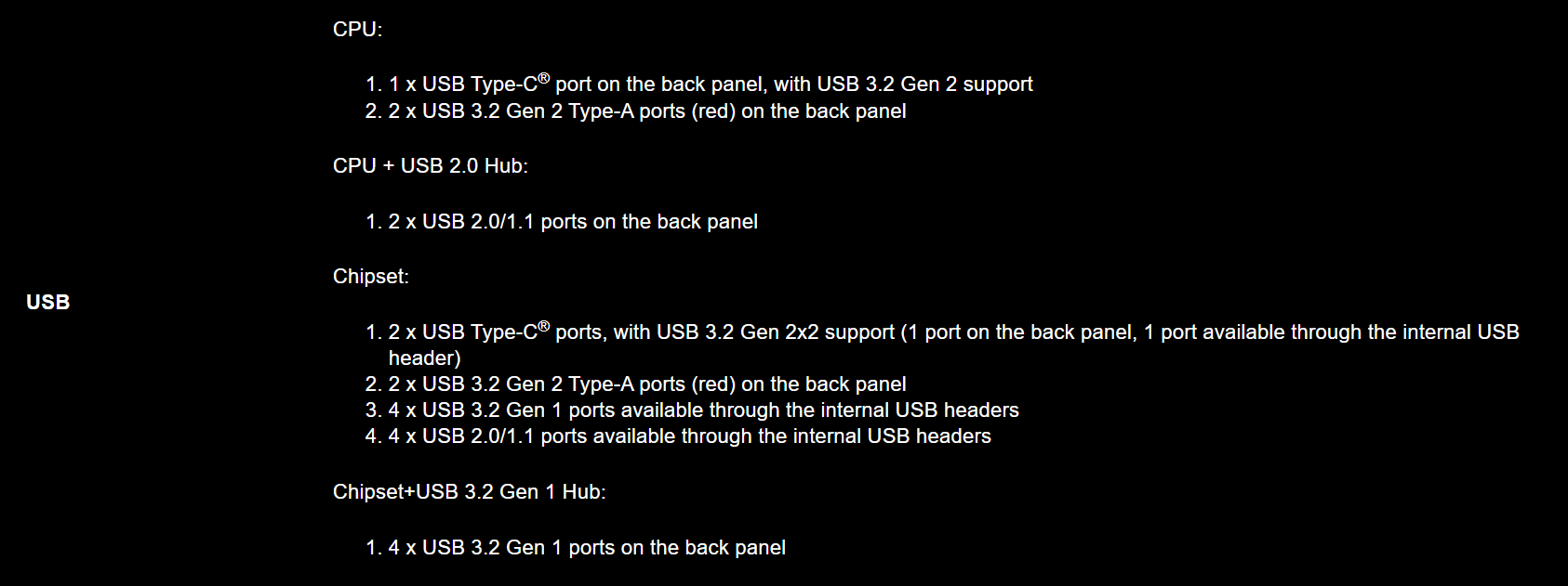

Solution No 1: Find a USB-Port on your PC, which is not driven from your mainbord chipset but from your CPU
I had a look in my mainboard specs and there i could find which USB-ports are driven by chipset and which are driven by CPU.
I plugged the RTL-SDR device into one of the two USB2.0 ports on the backpanel: Worked!
I plugged it into one of the two USB3.2 ports driven by the CPU: Worked!
Using one of the 4 USB3.2 ports driven by the Chipset: Failure
I use any of the connectors on the front panel (each of them is connected to an internal header which is driven by the Chipset): Failure
So if you are lucky like I am and have tons of USB ports, then there is a chance some of them are driven by the CPU. Look into the Mainboard manual or specs.
Solution No 2: Get a PCIe expansion card with USB-ports
You can get some for apprx. 15€
For the record, my pc specs: CPU: AMD Ryzen 7900x, Mainboard: Gigabyte X670E AORUS MASTER (X670E chipset)
