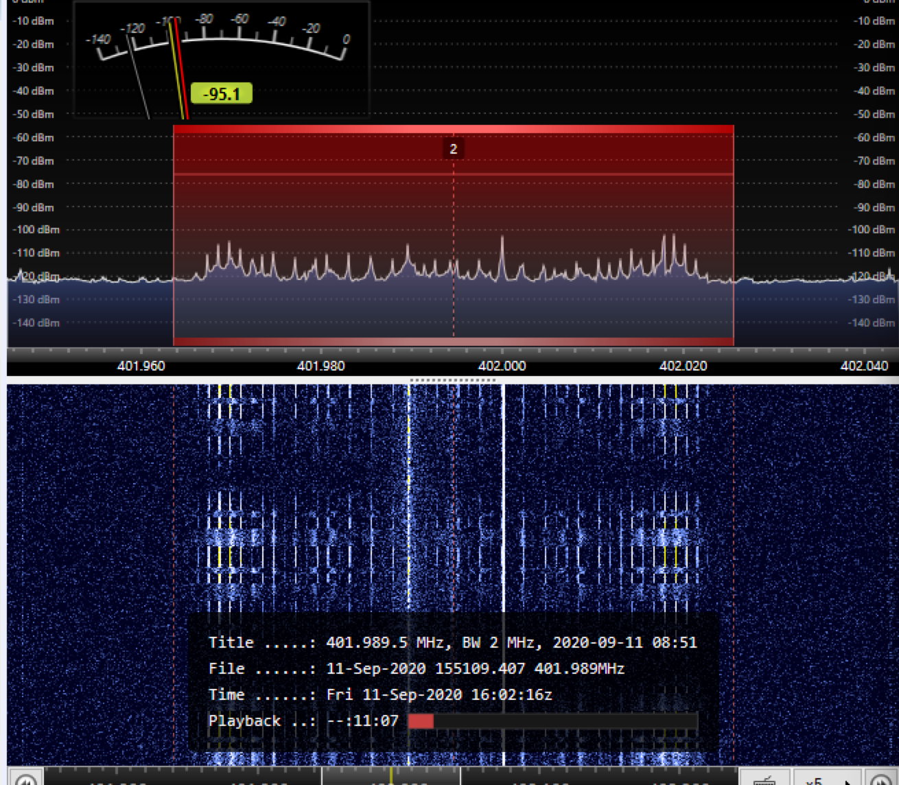

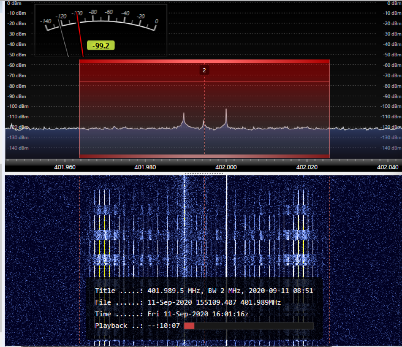

How would I null out birdies if there's no user adjustable notch filter?
I am trying to decode an AFSK signal 50khz wide, but it is straddling two birdies/DC offsets from a HackRF. The birdies are stronger than the AFSK tones most of the time, and are present when the transmitter is not turned on, so it's not a signal carrier from my data transmitter. I'd like to notch those two frequencies down.
If this is not possible, how do I export the IF recording compatible with other SDR apps that have notch filters?
Dan
Dan
- Posts: 2174
Re: Notch Filter Question
I'm afraid there's nothing you can do until I add a manual notch / notches.
