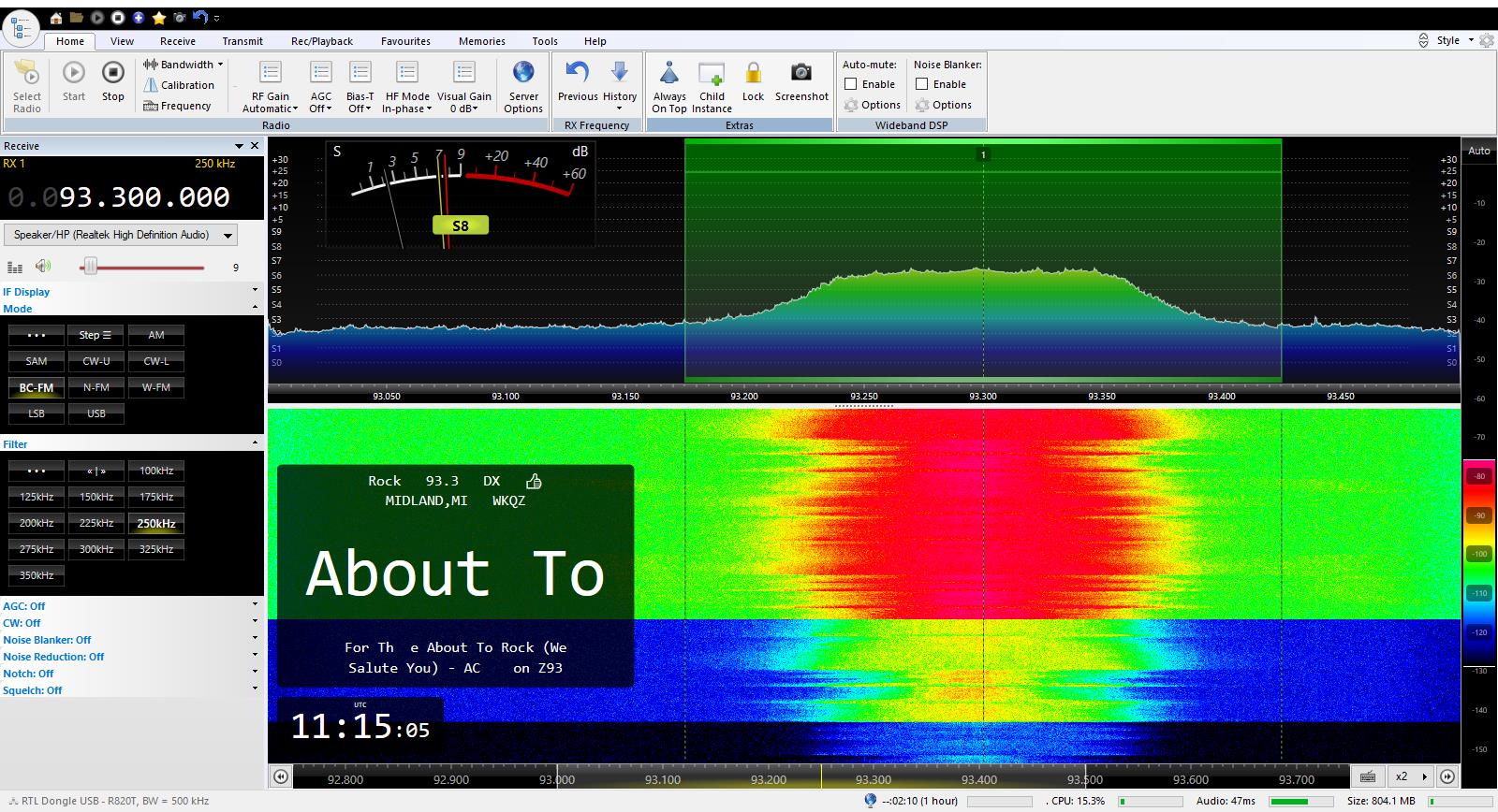

The RTL-SDR was rather deaf on FM (and off frequency), but suddenly the signal WKQZ Z93 FM jumped in signal strength after selecting a manual and going back to automatic RF Gain. See attached image of selecting from default of Auto, to manual, back to Auto. Max useable bandwidth was also 500 kHz, or the momentary pauses in audio happen.

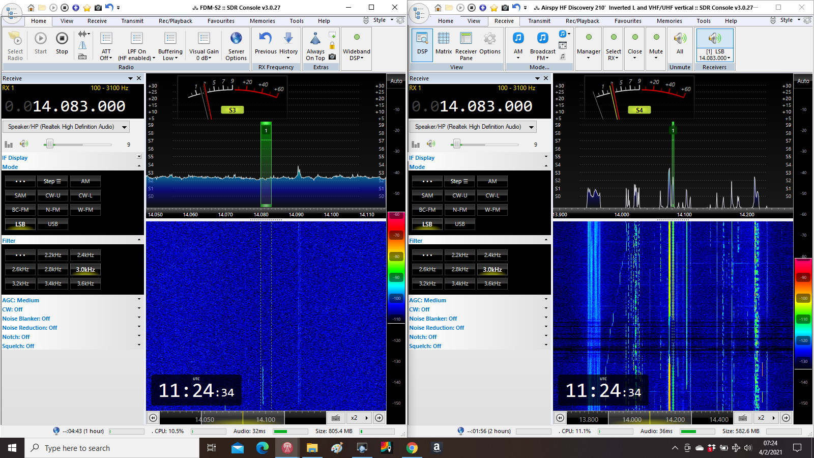

HF antenna seems to work well on 160 and 80M, still too early to test the upper bands. I briefly went to 20M and was completely dead except for some QRM streaks every 61 kHz. Not even and FT8 signals! See attached comparison screen shot.
