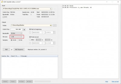

Thank you. I downloaded and installed 3.0.27. I ran the Data File Editor and as in V24, I can see no way to split a large file. Instructions?

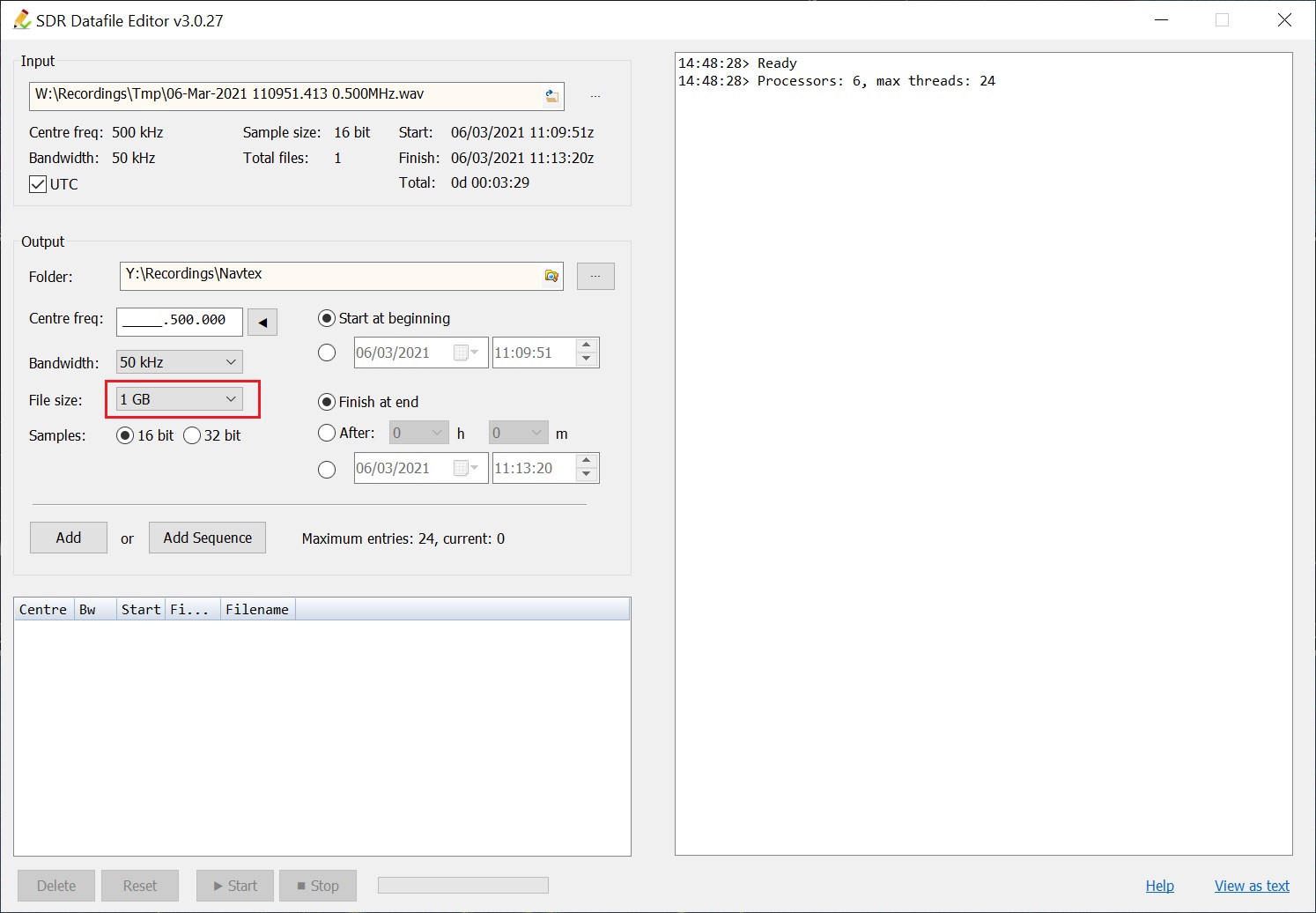

Windows Start >> SDR-radio.com (v3) >> Datafile Editor is what you want.
Re: Splitting SDR Console Recording Files
Select 1GB output files. I think more file size options should be added.
