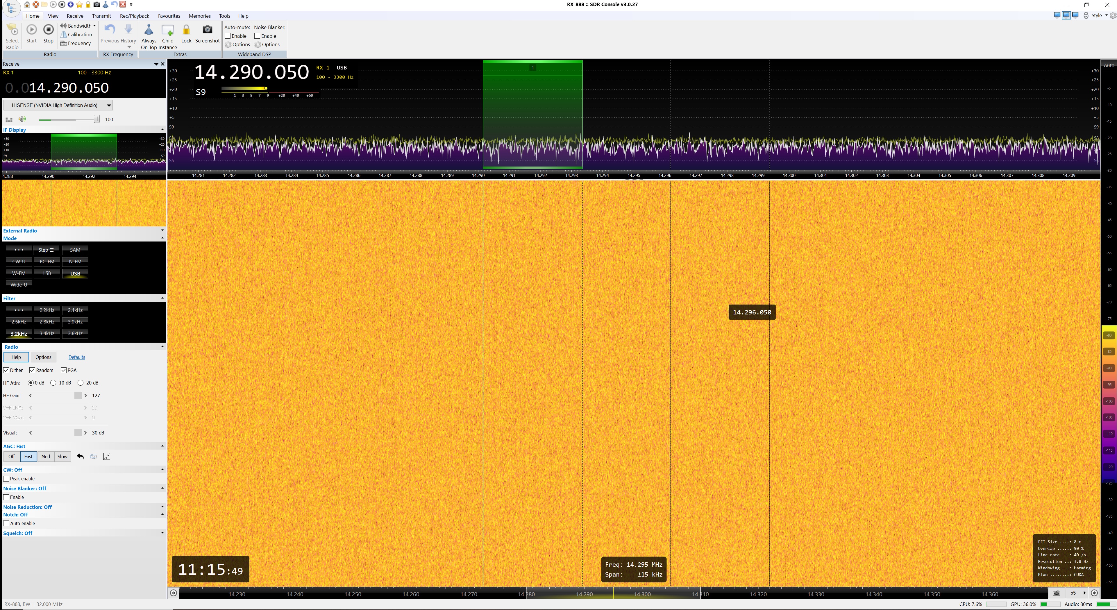

seems theres no gains in this one either
https://lirp.cdn-website.com/46d0be53/d ... -1920w.png

The screenshots title shows it was discovered as an RX666.
You should delete this and rediscover the radio as an RX888.
Good luck.

seems it works now after redetecting the driver for the rx888
thanks bagmouse7 you have a sharp eye :D

You have the HF gain set all the way up in that screenshot.
Set the gain down to 40 or 50.
