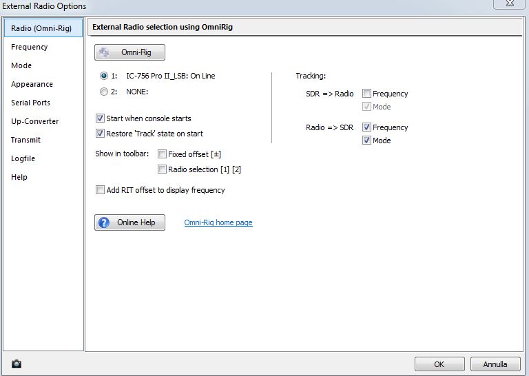

Is the External Radio options set to IF Output?
[/quote]
Yes, of course

if no Radio=>SDR or SDR=> Radio selection is activated, the behaviour is the same displayed in the example in the previous post, no difference at all!
if both Radio=>SDR or SDR=> Radio are activated, point and click as well as frequency update in spectrum/waterfall is active but very very slow with spectrum freeze and no smooth transition during VFO sweep in waterfall at all. Anybody using external radio is experiencing the same behaviour?
