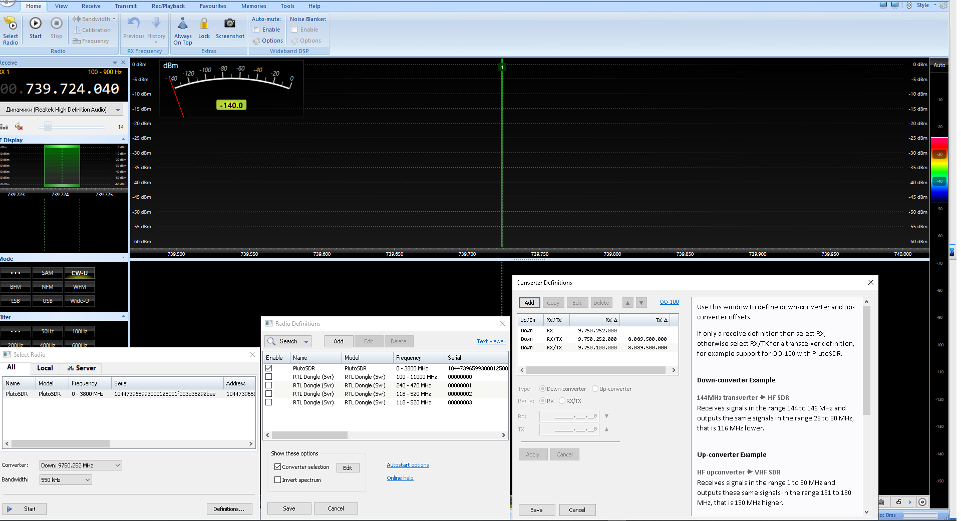

Welcome, dear Simon!! Please help me with the problem of displaying 10ghz on my console... The converter settings are made and displayed in the window, see the screenshot, but there is no display of the fundamental frequency... what should I do or what am I doing wrong??

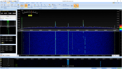

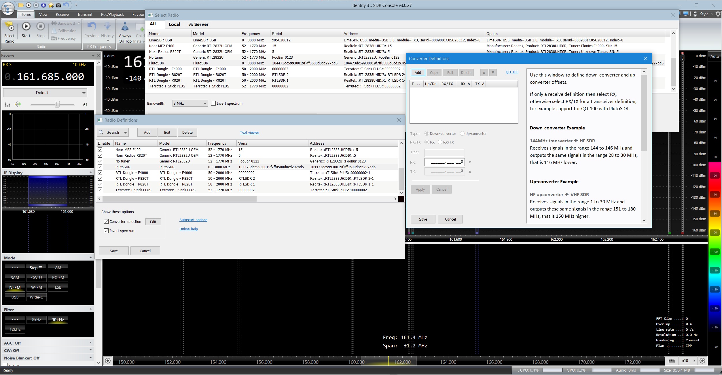

The screen shot did not make it. (Makes sure it is full size. And ideally show the same sort of information as I have in this image, edited for file size. Use multiple images if needed. I cheated and clipped everything showing and cut out the part I wanted to show so that I got the three additional dialogs all in one image while showing other stuff of interest.)
Shows interesting information for this problem.

[img]
[/im Here is the image you requested..
Posts: 1043
Re: problem of displaying 10ghz on my consol
The status line would be interesting to see. But that should be enough information Sigi or one of the other satellite users can help you. I hope he finds this. (I am WAY out of the satellite's footprint so have no practical experience with it.)
What I'd try now is press the little keyboard button lower right. Struggle through entering the center frequency you want on that keyboard and the span. Then upper left use the scroll wheel on your mouse to enter the receive frequency you want. It should be possible.

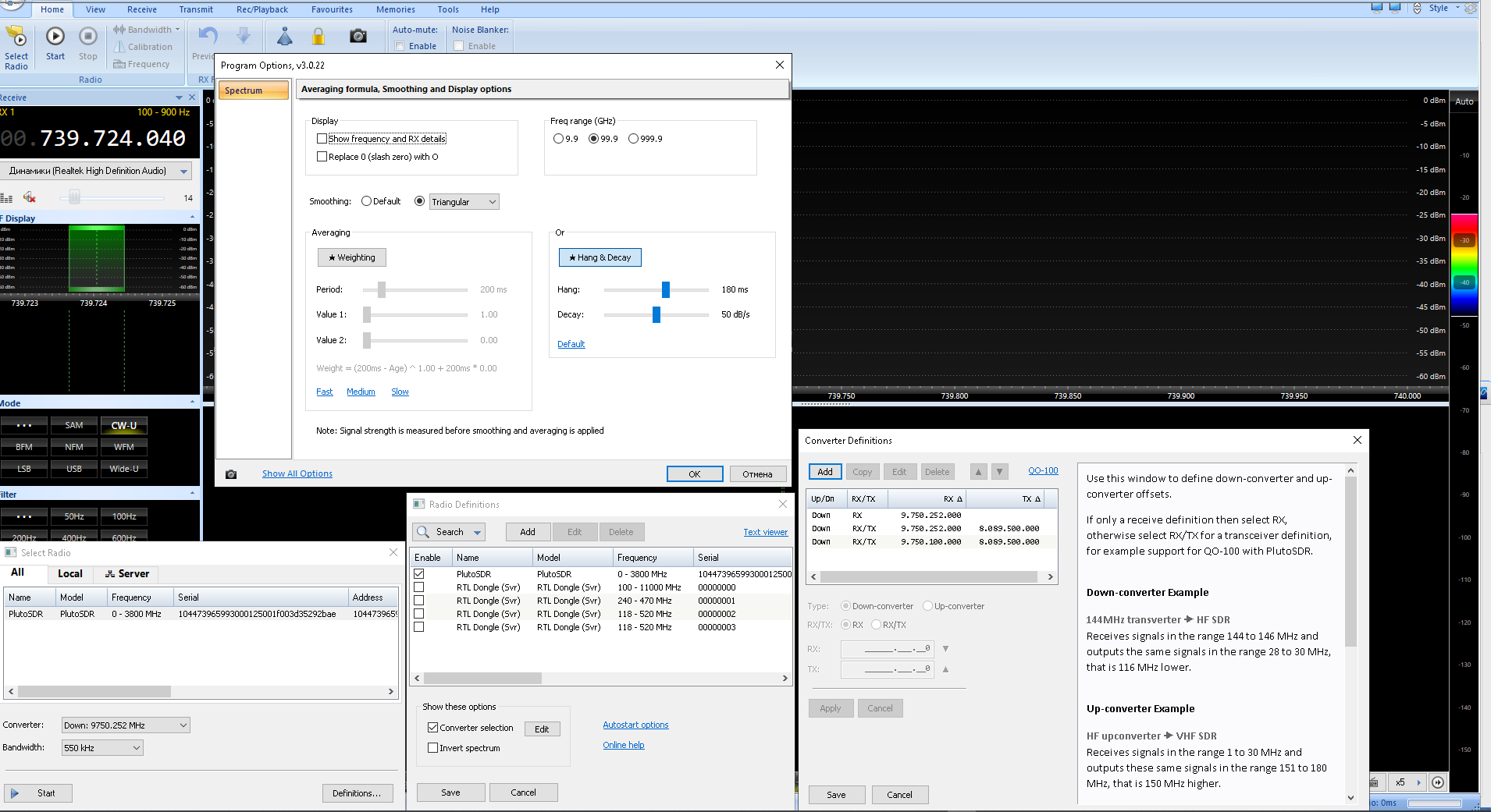

Good time! Here are the settings in my console. it is indicated that the converter is enabled, but the frequency is not displayed properly...

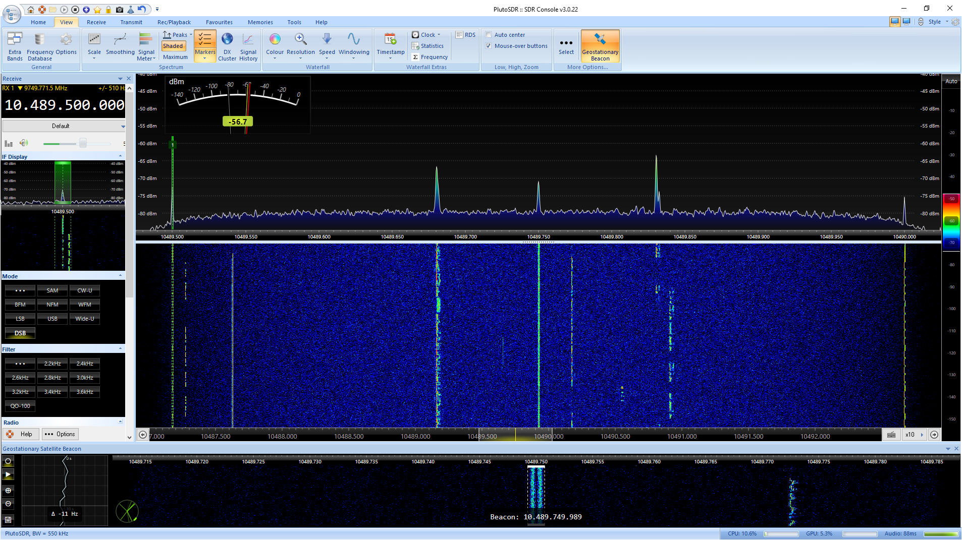

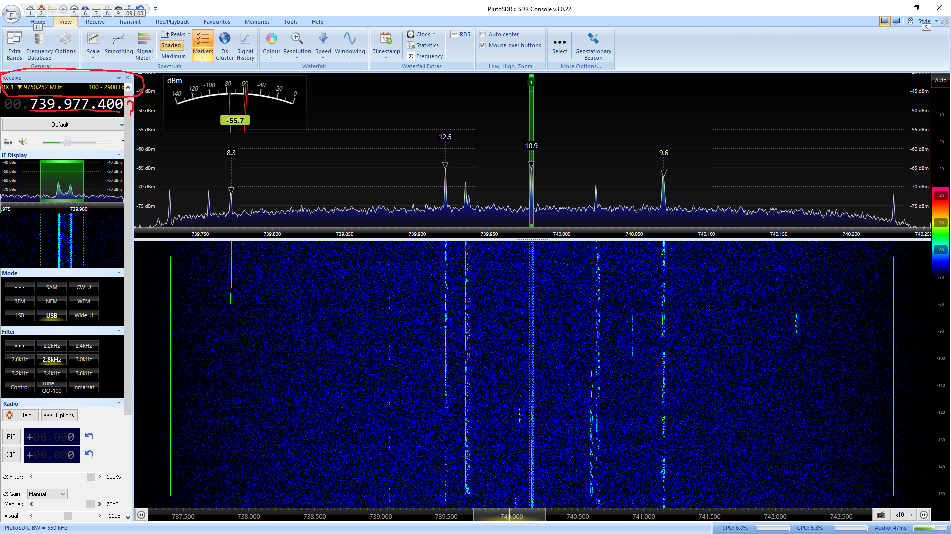

Have you tried to set the frequency to 10489750 MHz. You may be looking at a (sub) harmonic. If I set my freq to 739977 I get similar to yoy.

Thank you very much!!! everything worked out!!
