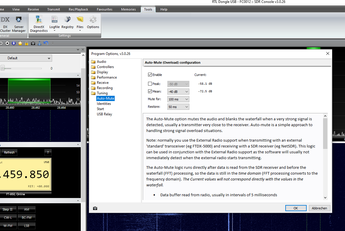

Im using a RTL Stick and Omnirig as Panadapter on my FT-950 an it works very well.
Usulay the computer audio is turend off and I'm working only with the Waterfall BUT sometimes I like to use the Computer Audio special for weaker Signals.
But when im sending I hear myselve over SDRConsole and this is annoing.
I tryed to configure Auto-Mute over the Tool Tab but had no luck with this.
Can anyone help me out ??
thank you
tom[/font]

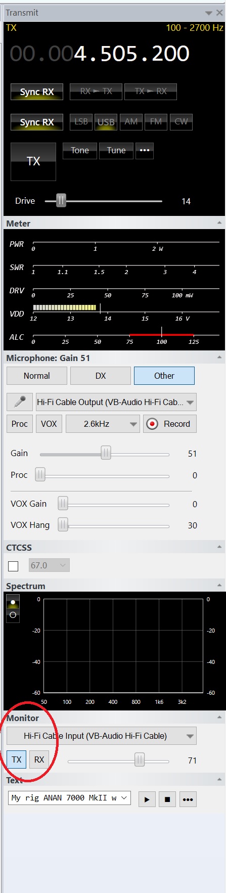

Hi, did you tried to disable TX monitor? (see red circle)
73, Leon

Thank you for answering. Unfortunately the whole Transmit section is grey and not accessible.
I thoght this is for sending with eg. HACKRF or so ?!
How can I get this accessible ?
73 tom

Sorry Tom, TX cannot be enabled with a RTL stick ofcource. Should have read better, my bad.

@Martin: I think you got it *g*. Yes, I'm using the internal IF for the RTL Stick. I hoped there was a way in the Software to Mute the Audio while sending. So, as you describe, I think I have to grad the RS242 signal with an Arduino and cut the IF input for the Stick While sending. Seems to be not too difficult to do..

I wonder if he has tried "home->options->AutoMute. Check the checkbox and set the muting levels. This only works if the signal when TXing is maybe 10 dB larger than incoming signals as a minimum.

jdow wrote: Thu May 20, 2021 10:42 am I wonder if he has tried "home->options->AutoMute. Check the checkbox and set the muting levels. This only works if the signal when TXing is maybe 10 dB larger than incoming signals as a minimum.
Thank you,
but as you can see in the initial post ... Yes. But it did'nt work as in the Screenshot (wrong Parameters maybe ?).
