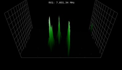

3D Waterfall
  • Pressing Escape no longer closes the window.

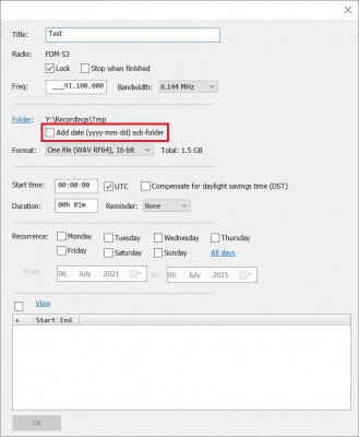

Recording Scheduler
  • Added a date (yyyy-mm-dd) sub-folder option.

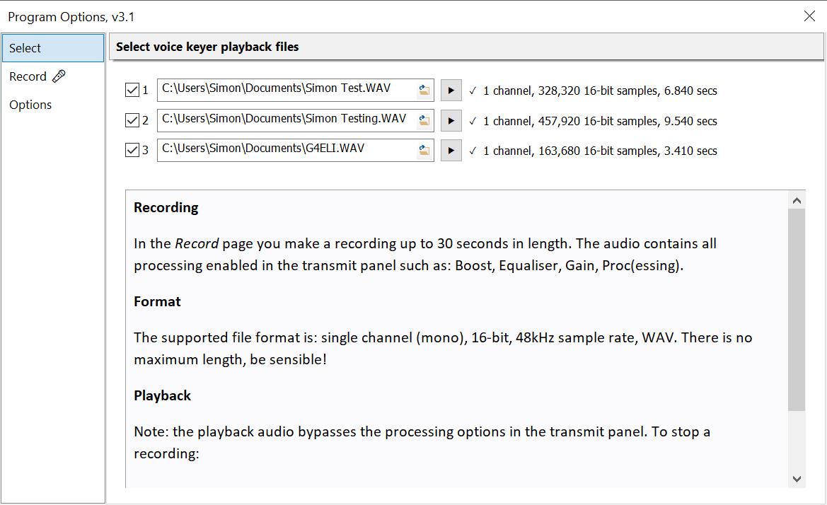

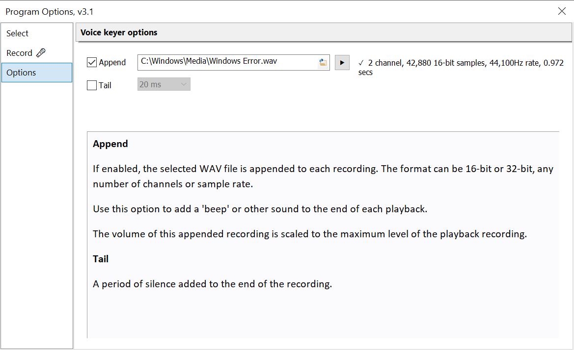

Voice Keyer
Added a voice keyer to the Transmit panel. Click ... for the options.

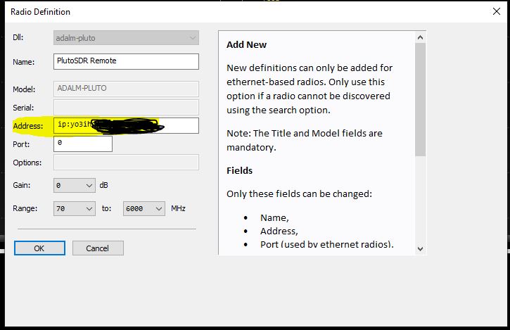

I am not sure if you can help me, but I found a problem when I am trying to access my QO-100 Adalm Pluto transceiver remotely.
On the Radio Definition I have configured the address as "ip:mypersonalDDNS" and port 0. It doesn't matter which port is configured here, as the software will send TCP frames only with destination port 30431 (checked with WireShark).

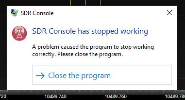

This worked very well and I was able to access my Pluto SDR from outside my network by using up to and including version 3.0.26.
However, starting version 3.0.27, the SDR Console is crashing if I try to connect.
If I put the external IP on the address field, like "ip:xxx.xxx.xxx.xxx", it is working as before, with no crashes.
Somehow the latest 3 new SDR Console releases doesn't accept the DDNS anymore on the address field.
I've tested on versions 3.0.27, 3.0.28 and the latest 3.1 (64 bit version only).
Any advise would be highly appreciated.
