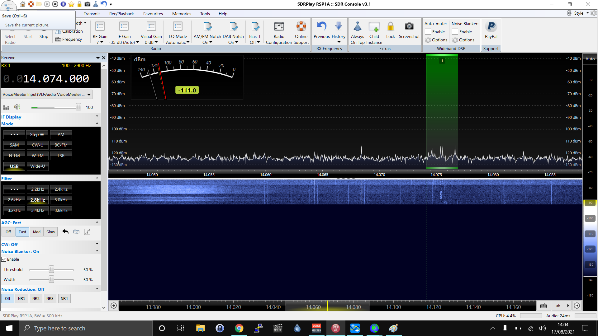

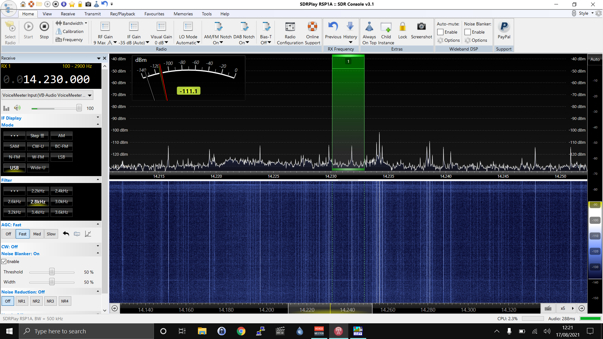

OK, not sure why that inline won't work, but I've gone for an attachment this time. This was working fine for 2 hours and then just failed and started skipping, the buffer increasing in length. Immediately switching to a different app and sending other audio through the cable has confirmed that side of things is working fine.
This has happened with an RTL-SDR Dongle and now my RSP1A as well, so I've been able to test on a few configurations.
Attachment 1: Upon starting the radio, buffer looks fine.
Attachment 2: When it fails the buffer climbs
