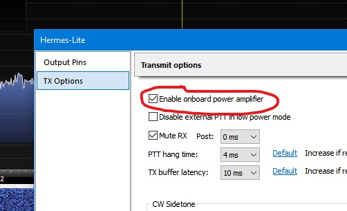

Hi Max,
Yes the PA box is checked and an external power meter shows about 4 Watts.

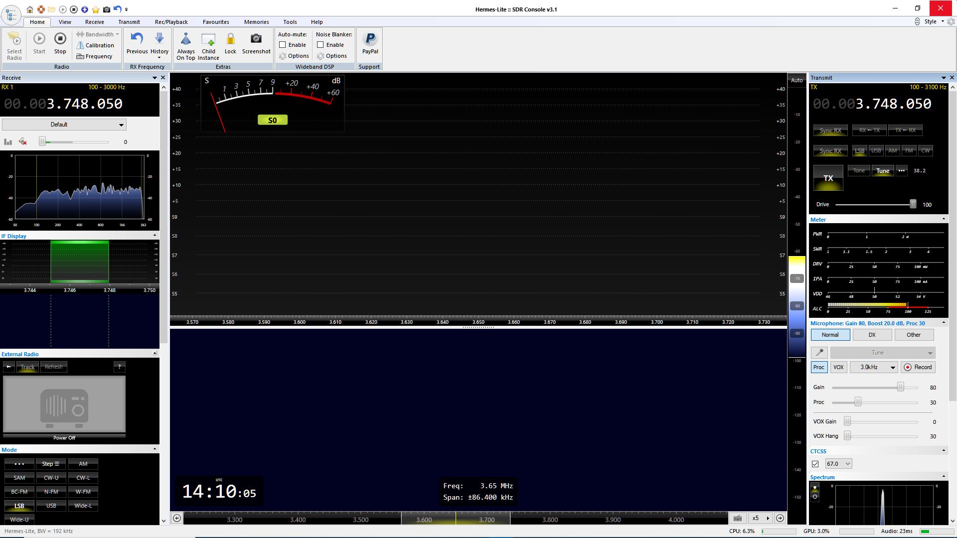

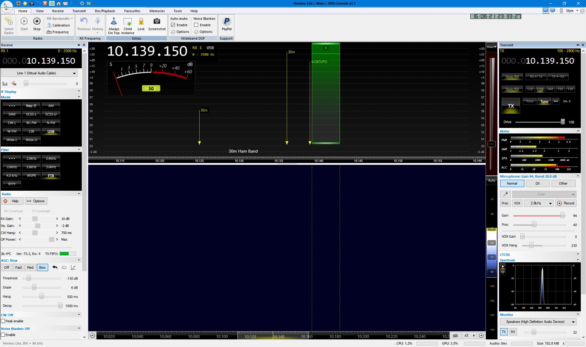

OK, trying to reproduce issue (without any luck) but now I've got something odd going on with the meters. Just realised that will SDRC at idle and no SDR started, I see the same TX meters in the TX DSP as you Roger. But once HL2 is running, the meters change and I lose the two meters "Drive" and "VDD". I'm not sure they are of use in HL2 anyway are they?
A clue perhaps Simon? See attached screenshot of what my "normal" looks like compared to Roger.
