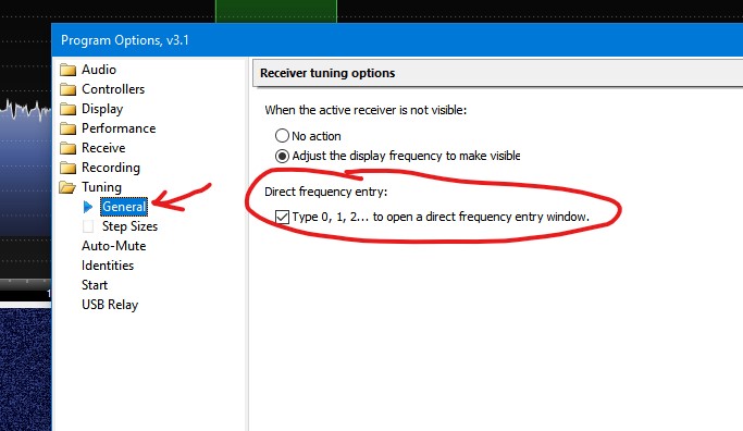

Posts: 1074
Re: Frequency And Span Window Question
Should have said for the last of the two options I mentioned to work (direct frequency entry) you need to have box ticked as in attached picture.
