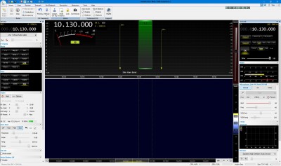

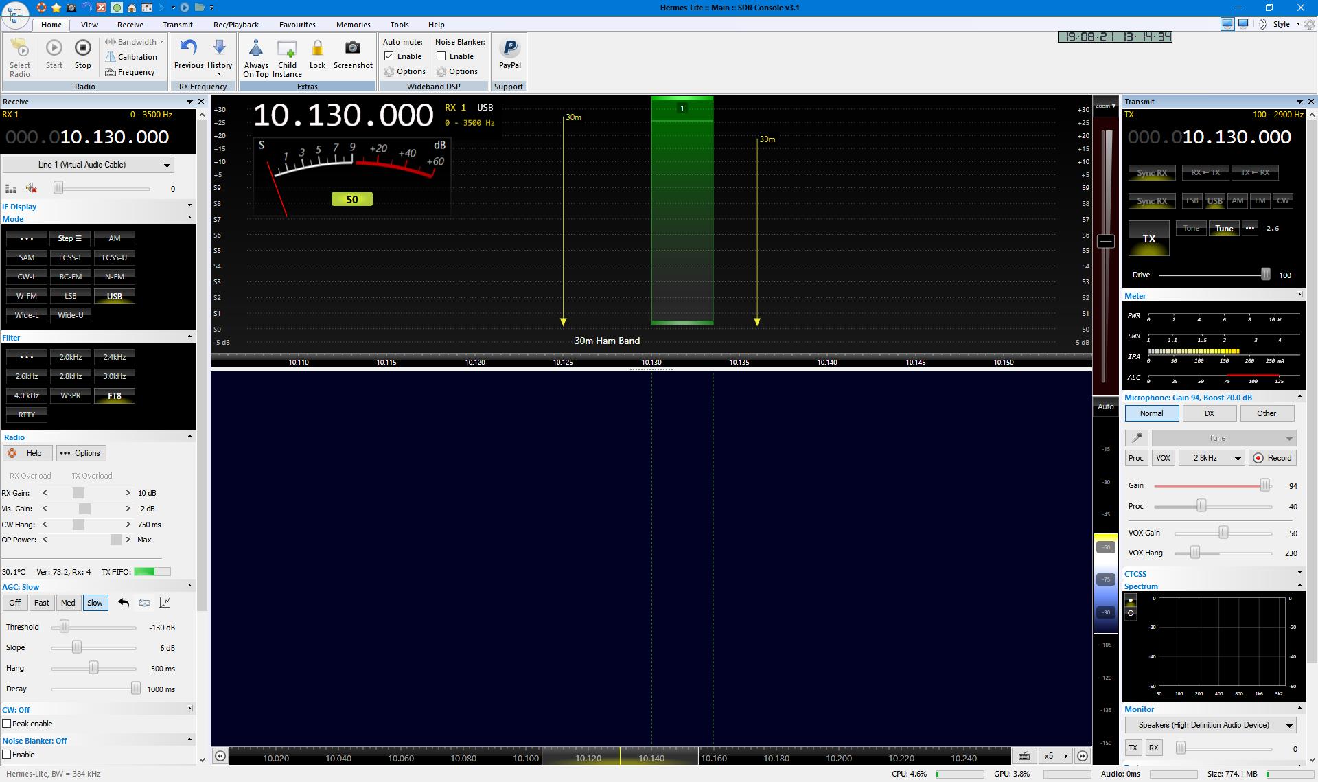

So for example, in the screenshot attached, you will see I am in "Tune" mode, and where I would normally expect the "tune" tone should be present in the audio spectrum box, bottom right of frame of TX DSP panel, there is no audio present at all, hence no TX output. It's the same for Tone input and it's the same if sending audio via VAC or sound card mic input. Absolutely zero.
Is it something I've done to Windows Audio that could cause there to be no audio, not even internal tone generation from SDRC? I've tried several stop-starts of Windows Audio Services, and I've also done full reboots of the PC at least three times. It's very curious. Any ideas appreciated. Screenshot and log file (putting SDRC into Tune mode) attached.

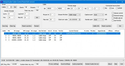

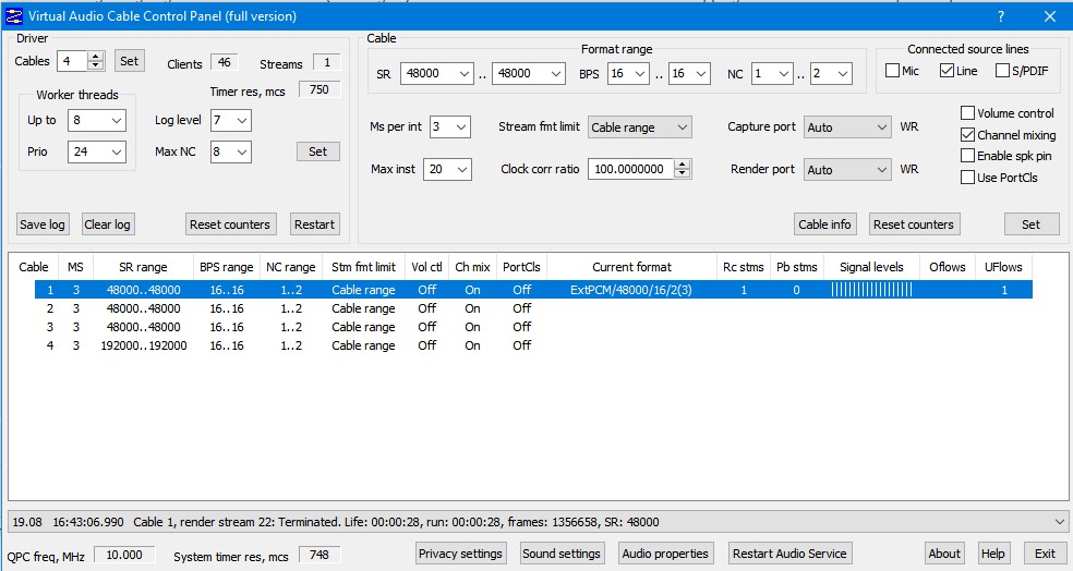

Don't suppose anyone sees anything in my VAC settings (attached)? I have no idea what half of them do! I'm using Cable 1 to output audio from SDRC and Cable 2 back in to TX audio input.
