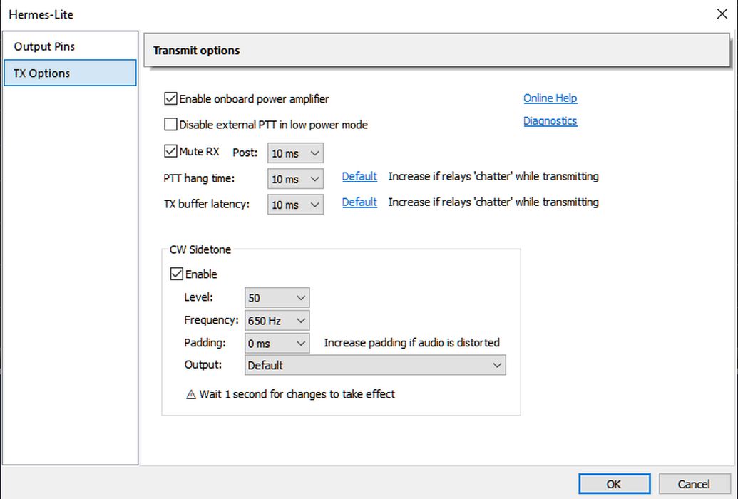

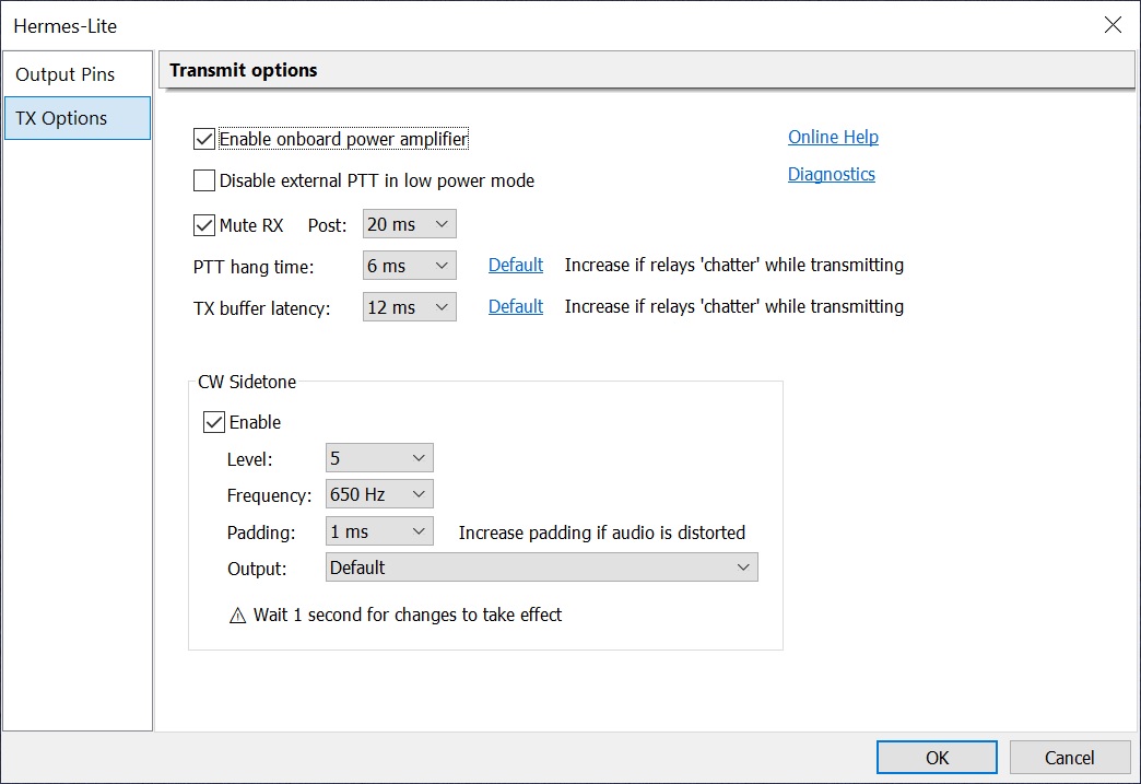

So,
HL2 dug out, please show me these options as set on your HL2. I'm now going to look through the code...
