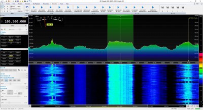

This is becoming even more "interesting." Found that the LNA is apparently dead. It cost me 10DB in signal being plugged in. Bias T is on. Automatic Gain control was responsible for the disappearance of the numerous stations that I can receive. I took it off automatic and reduced the RF gain to around 30. In some cases the gain must be set even lower to receive the stations. I've requested a replacement LNA. Also, the low ceiling of clouds is BACK as is rain that is heavy at times. It is so heavy, at times, that it can knock my satellite internet off line momentarily (It's Starlink).
I suspect that the increase in signal (noise) is due to have a discone antenna now when before I was using a dipole. The noise floor dropped and the formerly invisible stations are back. The noise filters seem to be related to the AGC and they will work on some stations, but not others. The ACG under the filter box doesn't work whether turned on or not.
The NR4 actually works on this particular station, but not on every station. Is it normal that once a station is stored in a memory that the bandwidth of the filter cannot be changed unless that placeholder is cleared, the bandwidth set, and then restored as a memory?

If you have a filter defined in a memory then it's applied when you select that memory but can be changed thereafter, just try dragging the filter with the mouse (big green bit at the top) or selecting another filter width.
As for NR - there are different algorithms which will work better depending on the noise itself.

Thanks, That actually does work. That was how I tried to use the filters initially (like SDR#) and found that it didn't work.Simon G4ELI wrote: Tue Aug 31, 2021 6:16 pm Hi,
