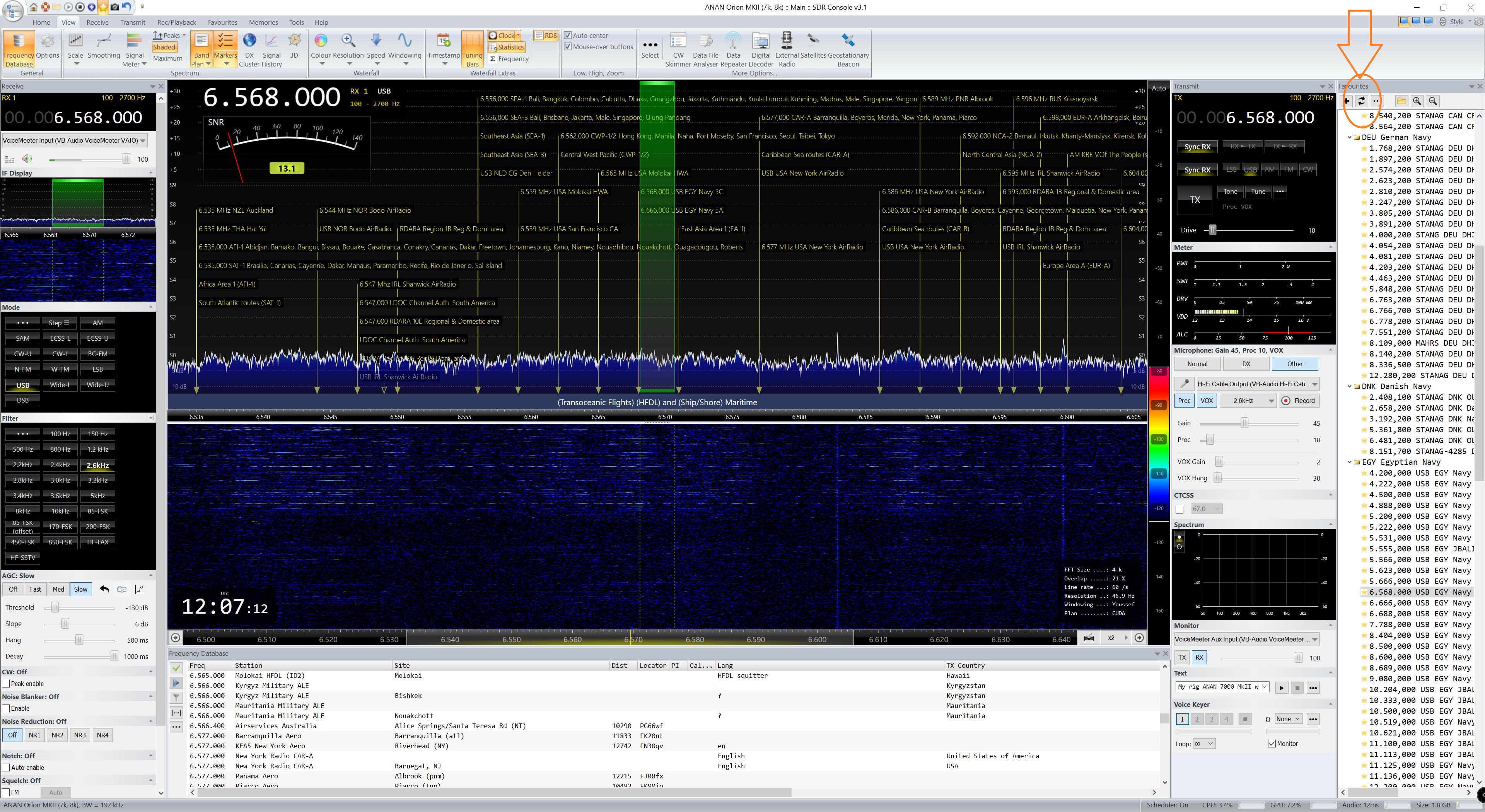

After editing about 50 FAV entries in a row the FAV ADD, UPDATE and Organizer buttons don't response anymore.
The buttons EXPAND, + and - are still working.
It also takes a very long time before Markers/Config opens.
After stopping the radio it doesn't start anymore. (Cluster Markers are off)
After a SDRC restart it works again for a while. I'm reorganizing a lot of Fav's (>500) so this happens many times. Mem leak? I'm not running other programs. The FAV file is 14,5 Mb, 4486 entries (in logfile).
