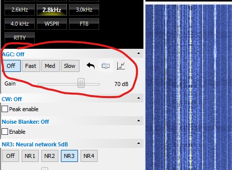

If I had to take a guess it's that you have no AGC selected in the DSP panel and the manual gain is set too high:
Either reduce the Gain slider or select one of the AGC modes, Fast/Med/Slow.

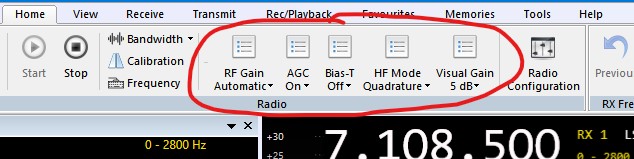

Also check the RF gain settings and RF AGC settings in the "Home" ribbon bar radio settings at the top of screen, particularly Visual Gain:
My money is still on the audio DSP AGC settings though.

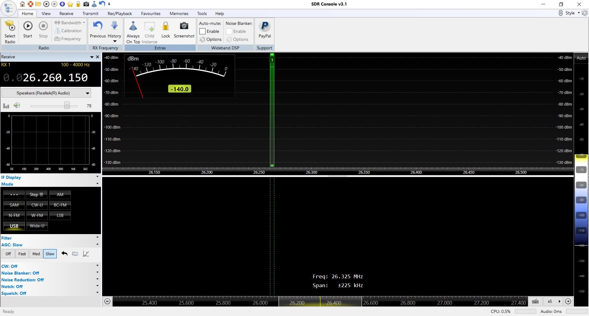

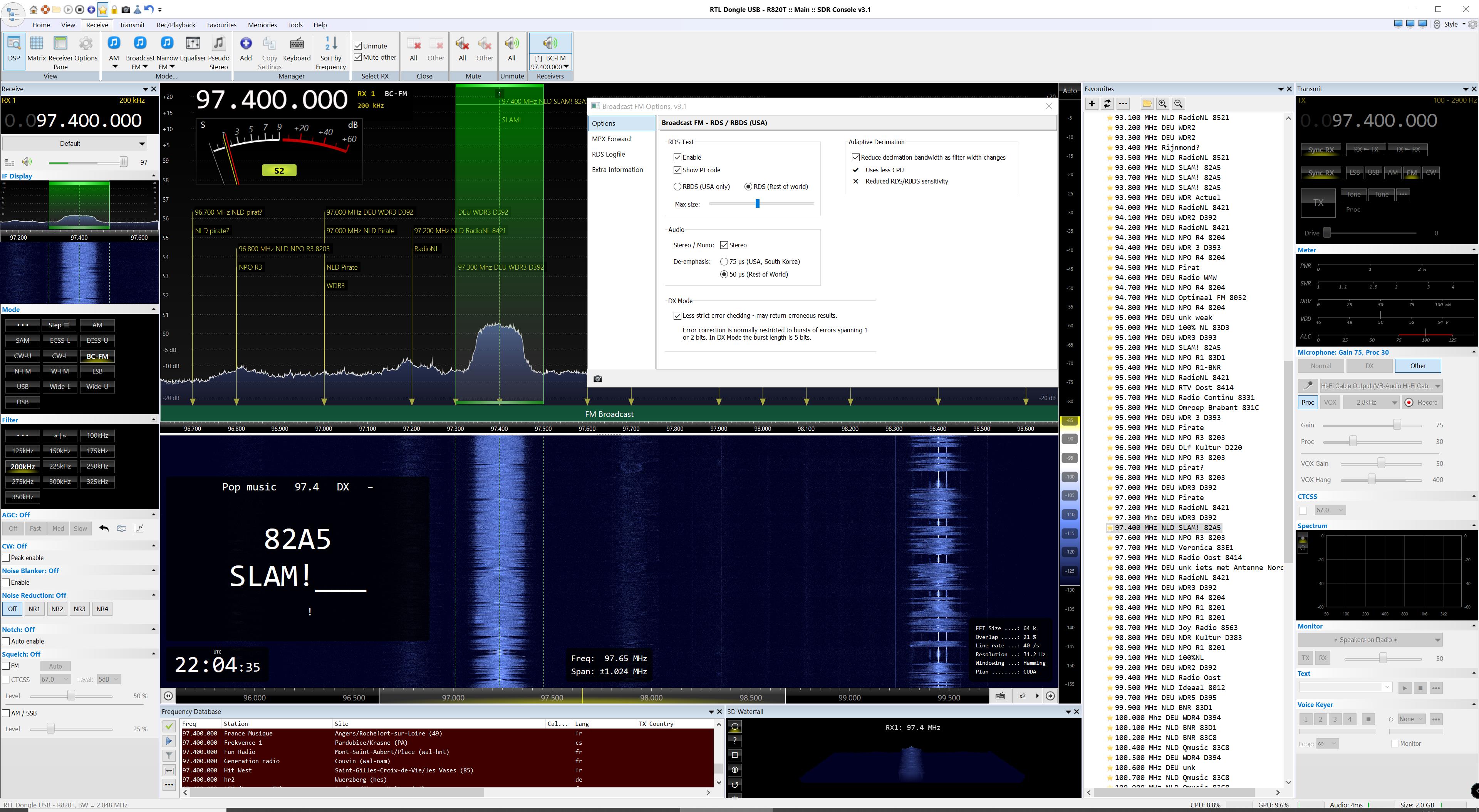

Re: Distorted Audio
Hi Rick, we like to help you but you're having a problem with FM broadcasts audio so we can't help you with a screenshot of a 26Mhz band part in USB and a radio that is not running. Please have a look at my screenshot as a example. (small antenna so signals are not big)
regards, Leon

As side notes:
For RTLSDR dongles the low frequency range of the tuner is not necessarily guaranteed. 29 MHz is a little iffy but "usually works", it may be overloaded by the very nearby 28.8 MHz oscillator in the dongle. You may find the direct sampling mode won't work well because that is very close to the dongle's crystal oscillator frequency of 28.8 MHz.
Without a picture showing dongle settings, including a picture showing the sample rate you have set up, you're not going to get more help than above because we lack information needed to provide it.
RickMarBen
Posts: 6
Joined: Sun Sep 12, 2021 11:15 pm
Re: Distorted Audio
Unread post by RickMarBen »
OK, this is it with dongle working in 28260.
